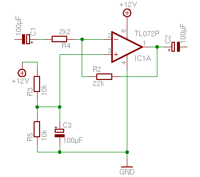

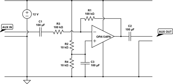

Hi all,
at the moment I'm trying to amplify an AUX-Signal with a 12V DC supply
voltage. I tried die setup from here as u can see in the picture below.
But all I get is just an annoying noise sounding horrible.
For the amplifier I used both the CA3240EZ and the OPA134PA.
Maybe my grounds are not connected correctly.
It would be awesome, if anyone could help me out.
Do you have a 0.1μF ceramic decoupling capacitor directly from the +12V power pin to the ground pin?
I betcha it is built with messy long jumper wires (antennas) on a solderless breadboard.
Welcome pixel.
I see the input impedance is quite low, and the output capacitance is high.
As cruts says you need a cap across the supply pins of the ic, a 10u and a 100n ought to do it.
What kind of noise do you get, hum, hiss?
What is the source of your AUX_IN signal and what are you feeding the AUX_OUT signal into?
What are you using as a 12V supply?

The "noise" is obviously extreme even-harmonics distortion and the 'scope shows the positive peaks are normal but the negative peaks have reduced levels. It might be caused by the low impedance input of the inverting opamp circuit overloading a source that pulls up well but pulls down poorly. At the end of your soundcloud recording there is a group singing (in Spanish?) with auto-tune correcting the pitch of their voices.

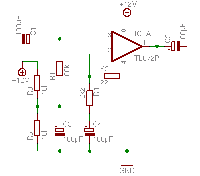

The schematic in your first post has 22k for the R1 feedback resistor so the gain of the circuit is 22k/2.2k= 10 times.
The second circuits you show have 2.2k for the R1 feedback resistor so the gain of the circuit is 2.2k/2.2k= 1 time (no gain like a piece of wire) but the signal is inverted.
The feedback resistor has nothing to do with the input impedance. The distortion might be caused by the inverting circuit has an input impedance that is too low but if you increase the value of the input resistor R3 then the gain is reduced unless you also increase the value of R1 but you do not want R1 to be as high as 1M because stray capacitance might cause oscillation.
Why don't you make the non-inverting circuit that has a 100k input impedance and a gain of 10 times??

To me, the sound you have recorded implies that either the IC is being way over driven or you have blown one of its output devices.
Does the amplifier work when configured in the noninverting circuit?
Why are you trying to invert your signal anyway?
goes directly into my subwoofer.
Is that just a naked speaker, or is it an amplifier driving a speaker?
The IC can only source/sink up to ~35mA. What is the input impedance of the subwoofer?
An opamp cannot drive a low impedance speaker. You need a power amplifier to drive the speaker. The opamp was limiting its current which caused the severe distortion.

Sounds like you are getting very bad clipping.
We need to know EXACTLY what you have connected to the input, and what you have connected to the output, or else we can only guess what is causing this. You need to specify these two things.
Another problem with the opamp circuit trying to drive a speaker is that the output capacitor passes only high frequencies. 100uF feeding a 4 ohm speaker cuts off frequencies below 400Hz.
If the opamp limits current to 35mA then 35mA is the peak but 24.7mA is the RMS current. The maximum undistorted power into a 4 ohm speaker is only (24.7mA squared) x 4 ohms= 2.4mW which is a VERY low level. you turned up the volume too much.
For 10W the RMS current must be 1.6A and the peak current must be 2.4A. Then the current is 100 times more.

You are blowing up the input of the opamp with a signal level that is much too high for it and you are overloading the output of the opamp with a load resistance that is much too low for it.
Why do you want to amplify the subwoofer signal? If you want more power then you need a more powerful amplifier and a larger subwoofer speaker. On a normal stereo you add the preamp at the INPUT of the subwoofer power amplifier, not at its output. But this system does not have an input to the subwoofer power amplifier, it is inside the circuit after a lowpass filter.
