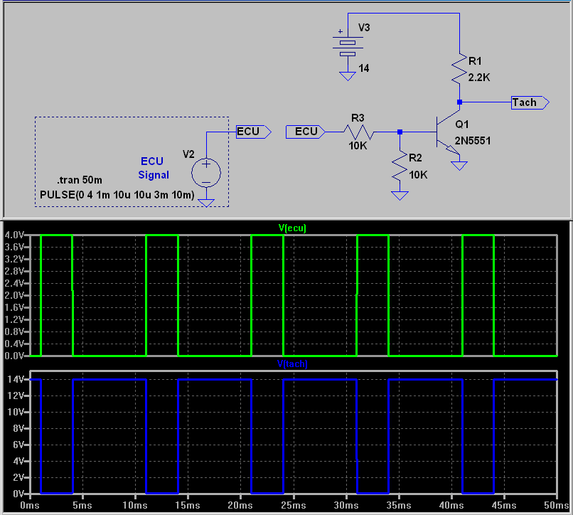

I'm trying to get the rev counter working on my current car project. My output comes from the ECU & is a 4-5v signal (I don't have the equipment to test frequency). My tacho requires a 12v signal (it was triggered from the coil originally). I have built a circuit to try and amplify the signal but it doesn't work & I have exceeded my electronics know how. Here is a pic of the circuit -
I'm getting a fluctuating 4-5v in and a steady 4v output. This is all DC.
You are trying to get a relay to follow the Tach pulse rate, which it cannot do. It takes ~20ms for relay coil to pull-in and up to 100ms for it to release.
Try this:

What you need to do is give us the diagram of the original tach circuit (or what car it's from).
There's a good chance your factory tach is expecting a much higher voltage than 12V (mainly because of the high voltage spike that occurs when the coil discharges) and the tach has a circuit to reduce this. Feeding this type of tach 12V may not be enough for it to work properly.
What I've done in the past is use a small inductor in conjunction with a transistor the charge it in order to generate a high-voltage spike and get my tach to fire off a 5V signal from an ECU.

eta:mikeml, the circuit I have made is very similar to the one you have pictured, mine has no R2, R1 is replaced by the relay coil. What function does R2 have?
R2 is there to make sure that the transistor turns off correctly and quickly when the input is low. It may not be needed, but it can't hurt.
Your relay coil may well produce spikes that trigger the rev counter, but there is a danger that you could damage the transistor, which is rated to 160 V or so. You should put a resistor in parallel with the coil. Chose a value about 10 times the resistance of the coil and you should limit the voltage spikes to about 120 V.

I'm assuming not. The tachs designed for point-coil ignitions have a filter to get rid of the inductive spikes which naturally occur across the coil primary when the points open. However, if you feed them with a clean 12V pulse from a laboratory signal generator, they indicate the correct RPM. They generally dont care what the duty cycle of the pulse is; anything from about 10% to 90% seems to work just fine. The circuit I posted is just a simple amplifier; it makes a 12V pulse out of a 4V pulse.
