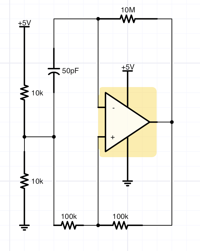

Hi everyone, I building my home project and I built capacitive sensor. When sensor detect value raise just between 0.5 and 1pF. I need this signal to amplify for use on arduino and I don't have many components. Can you help me?

One way to measure the small change in capacitance would be to incorporate the capacitance into an oscillator circuit, preferably one which was built very close to the sensor to minimise the effects of connecting wires, and use the arduino to measure the frequency of the oscillator.

is it a change from 0.001 pF to 1.0pF,
or it a change from 500pF to 501pF?
From ~ 50pF to 51pF
In theory, a circuit like this will give you a frequency shift from about 890 to 910 Hz. It is a big enough shift to hear with even average musical aptitude. But, theory and reality is all in parts selection and implementation.
you can use a timer on a microcontroller to measure the period of the amp output. The faster your microcontroller, the more resolution you will have... assuming you can get your capacitor to oscillate your circuit.
