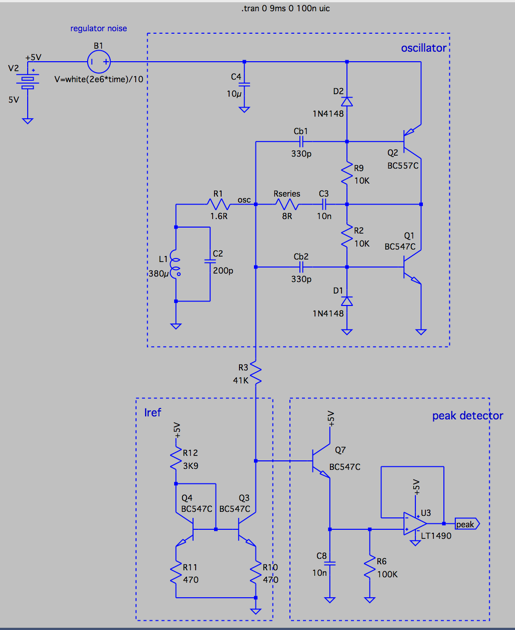

My project involves the "loading effect" of a metallic object upon a free-running LC oscillator. This means that the amplitude - and to a lesser extent the frequency - of the oscillator changes as the object gets closer to the inductance.
My oscillator produces a 40Vpp sine wave. Before applying the peak detector I subtract 37V DC so the peak is 3V maximum. This is like "zooming in" into the peaks, which allows to detect small amplitude variations of the order of a millivolt in the 40V range.
You would assume that the amplitude of the oscillator (the envelope after peak detection) would be constant if the power supply is well regulated. Well, this is not the case, instead, the amplitude behaves like a "random walk" (Brownian motion) drifting up and down in what appears to be huge "pink noise" also known as "flicker noise" or "1/f" noise. In this case the drift is in the order of the 100's of millivolts, so large it buries the signal.
Google taught me that flicker noise is the integral of white noise, and since the LC circuit is in fact an integrator, any noise injected by the power supply or the components of the oscillator will result in 1/f noise.
I've tried to remedy this by using a battery as a power supply + big capacitor, since regulators are noisy. The drift is a bit less but still remains.
Any ideas on how to minimize this annoying effect?

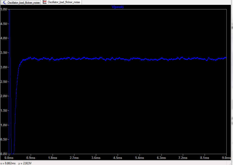

Attached: LTSpice simulation. I've added the white noise source BV to show what the effect looks like (plot V(peak)) as it happens in the real circuit without BV.

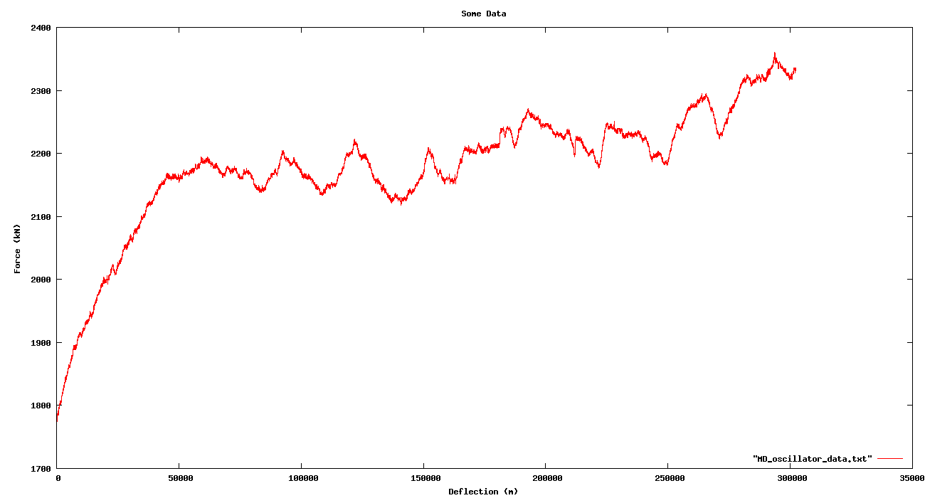

That is a real graph or simulated? What in the hell are you doing that the deflection is 300 kilometers?

Scratch that, this is what I get with maximum time step of 1ns. I gues your result comes mostly from some truncation error in the solver.

P.S. The graph shows real measures. A "300 Km." swing translates into roughly 300mV. I didn't bother to change the units, sorry.

300mV of what? I thought you were measuring some distance or something. Can you please label what each axis actually is and how it relates to the circuit?

I can see a couple of problems with the circuit.
1. By subtracting a fixed 37 volts, the relative noise voltage increases significantly. If the noise voltage is x then x/3 is much greater than x/40.
2. Using a current source and a resistor as a means to subtract the fixed voltage is a potential noise source. Have you considered using a 37V zener? Yes, zeners are noisy too, but it would be interesting to see a comparison.

I appreciate your comments. By the way, the LTSpice schematic is attached to the first post.
I think if the noise were due to the antenna effect it would be periodic rather than a random walk. The sine wave looks pretty clean on the scope, but here's we're talking tens of millivolts on top of a 40V peak, so radio interference might as well be hiding there.
Let me expand on the details:
- The circuit is a serial LC resonator around L1 and C3. Resonant frequency is 81KHz.
- L1 is shielded and the shield is grounded.
- C2 is the parasitic capacitance of the coil. Impossible to remove.
- R1 is the resistance of the coil. Rseries is the ESR of capacitor C3
Apart from shielding, which I already have done, what other measures can be taken to avoid the antenna effect?

There is a reason. I'm not interested in the oscillator signal itself, but in measuring tiny changes in the amplitude of the oscillator induced by a nearby metallic object. The intention is to maximize the sensitivity, and that's where noise gets in the way.
Emitter degeneration resistors (R11 and R10) drastically reduce the noise of the current mirror, much lower than a zener's. Unlike a zener, the current mirror is adjustable, keep in mind that the applitude of an oscillator is hard to predict, changes with temperature, etc. An MCU can modify the current dynamically to maintain the working point.
