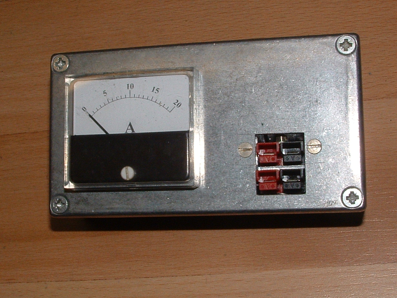

The meter scale itself was a bit of a problem. The meter was originally used in some long dead piece of equipment and had a non-linear scale calibrated in dB. Not very useful for my application.
I was about to hand draw a paper scale when I remembered that there is an application somewhere in the interwebs which can be used for printing meter scales.
After a bit of searching I found it, it is called GALVO, as in Galvanometer.
EDIT: Ooops! WRONG, it is called GALVA rather than galvo.
It was originally written in French, but there is an English user guide and version which has mostly English commands.
Anyway, after all this waffle, here it is:
![12v Ammeter 006.JPG 12v Ammeter 006.JPG](https://www.electro-tech-online.com/data/attachments/91/91483-46d545543a9ebf0da6e54dd3ef0fee16.jpg)

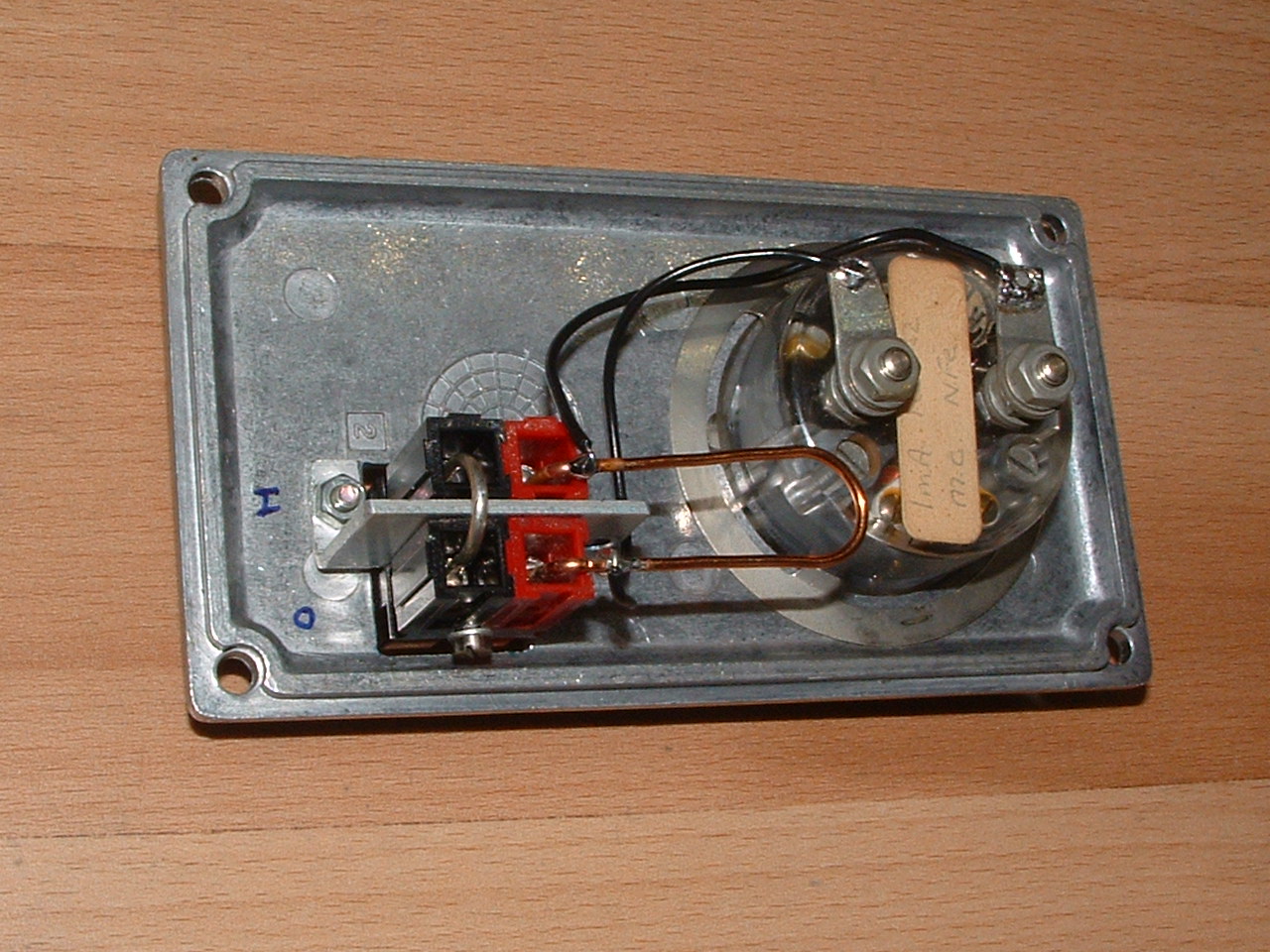

And inside:
![12v Ammeter 009.JPG 12v Ammeter 009.JPG](https://www.electro-tech-online.com/data/attachments/91/91484-37883aab7c1c900dfac834044b6eed2a.jpg)
My home made shunt can be seen extending out to the righthand side of the red terminals, and bent into a hairpin loop.
So there it is.
The solder connections to the meter look as though they could do with tidying up a bit.
The hole in the box where the connectors protrude is a bit on the big side. A classic case of measuring very carefully and still getting it wrong!
I also need to make a label for the connectors to show which is IN from the supply and which is OUT to the load, otherwise the meter deflects the wrong way (obviously), making another source of annoyance at busy times on the workbench.
