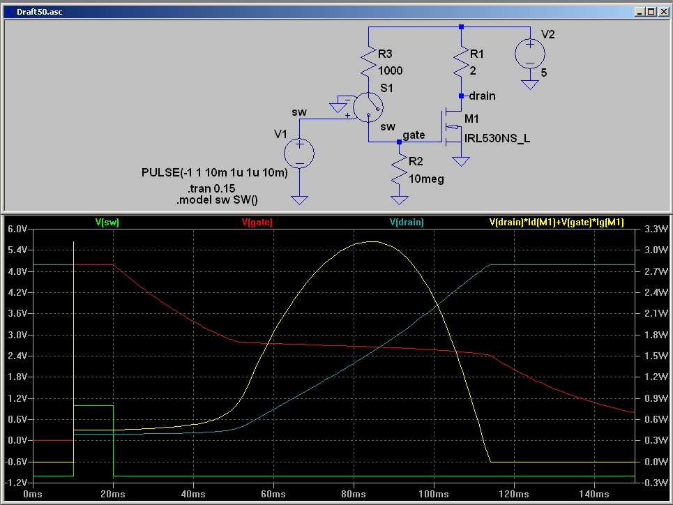

One minor additional factoid. In the original circuit with the mechanical switch, if the pull-down resistor value is too high, say 10MegOhm, it will take a relatively long time for that resistance to discharge the FET's Gate input capacitance, so the FET will slowly transition through the region where it is partially on, partially off. When FETs are used as switches, to minimize power dissipation (Vds*Id), it is desirable to get through the partially-on region as quickly as possible, so that RC time constant must be considered.
Look at the attached simulation. Due to the unrealistically high pull-down resistor, notice how long it takes to discharge the gate capacitance. Note the power dissipation in the FET (yellow trace). Note that the gate voltage (red trace) looks like an RC discharge curve with a flat spot in the middle. The flat spot is due to the Miller capacitance from drain to gate. The flat spot persists while the drain voltage (blue trace) is transistioning upwards (turning off).
Great contribution Mike, thanks. So, as far as I understand, a high resistor value cannot always be a wise solution, if high switching is necessary (for example if a pwm is used to switch the gate on and off).
