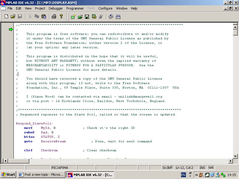

An error in pic16f84a, why?
Zener_Diode
hey....
I downloaded some files with unilink code. when I compile it I have got an error on line with ";".
Does someone know why?
the asm files I downloaded from:
http://unilink.diglin.com/mode_emploi.html
choose there Unilink_project
Thanks a head....
p.s. I need to run the program on pic16f84A.

When I save it in a wordpad and run a compile in MPLAB, it founds me errors:
Error[150] C:\MP3\MP3\DISPLAY.ASM 23 : Labels must be defined in a code or data section when making an object file
Error[113] C:\MP3\MP3\DISPLAY.ASM 24 : Symbol not previously defined (MyId)
Error[152] C:\MP3\MP3\DISPLAY.ASM 24 : Executable code and data must be defined in an appropriate section
Error[113] C:\MP3\MP3\DISPLAY.ASM 25 : Symbol not previously defined (Rad)
Error[152] C:\MP3\MP3\DISPLAY.ASM 25 : Executable code and data must be defined in an appropriate section
Error[113] C:\MP3\MP3\DISPLAY.ASM 26 : Symbol not previously defined (STATUS)
Error[113] C:\MP3\MP3\DISPLAY.ASM 26 : Symbol not previously defined (Z)
Error[152] C:\MP3\MP3\DISPLAY.ASM 26 : Executable code and data must be defined in an appropriate section

what should I do now?
okkk
It is working fine.
All you need is the main asm file in your project, the rest is included in this asm.
Unzip the file and open it in your MPLAB IDE.
"open project"
STEVE
  • GNUnilink-1.8.zip
I can't write you a step by step tutorial !
The rs232 code writen for hartdware usart, 16F84 don't have one.
Save the trouble for yourself, go and buy a F627 or 28.
:idea:
Write to the author of the code !
or read thru the project!
maybe some one else can solve it for you.
good luck
STEVE
Sorry :arrow:
