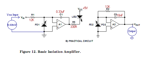

I have a problem with an analog isolation, I want to isolate a DC signal various between 0 - 60mV.
I use a HCNR201 and the schematic of the datasheet (page 9, figure 12B)

What are the values of the 2 resistors in your circuit of 12B..??
thank you for you answers
the power supply is 5V and the values of resistance are
12Kohm for the resistor connected to the "-" of the first Op-Amps
330ohm for the resistor between the Anode of the LED and the output of the first Op-Amps
12Kohm between the "-" and the output of the second Op-Amps
the values of capacitor are 0.33uF for the first Op-Amps and 10nF for the second Opamp.

If I read your first post correctly you are trying to drive the LED.??
You should connect your 0 to 60mV to Vin on A1 and read a 0 to 60mV on A2, Vout.
As you have a 12K on A1 and A2 you have an overall gain of unity [1]
The LED is controlled by A1 via the 330R, you do not control the LED.

Look at this image.
The A1 controls the LED drive, which is seen by both PD1 and PD2, you dont change the LED drive.

Forget about the LED drive, leave it to the A1 amp via the 330R.
It uses the LED to optically couple the two halves of the isolator.
There is feed back [LED] to PD1 and PD2 in order to make the coupler a LINEAR analog coupler.
You feed your input to Vin
How much gain do you want.?
At the moment the 12K with a 60mV signal gives 5uA current into A1, look at the datasheet graph.
If you look at the GAIN formula in the sheet you can adjust the two resistors to set the gain.
OK.?:)

I want a Gain of 1 or of 83.3. If i take a gain of 1, after i will use a no-inverter op-amps. Because, I have a signal of 0-60mV in the input and i have to transform this signal to O-5V DC with an isolation.
For the current in pd1, I think understand why i have 50uA (Ipd1=60mV / 12k),
in the datasheet, the gain of the formula is Vout/Vin = K * (R2/R1) ?
After this formula, the datasheet says that K=K3. And in the page 6, it says that the typical gain of K3 is 1.
So, I have take two resistors of 12kohm in the order to have a gain of 1, but maybe with this i don't have enough current , Do you think that it is better to use a resistor like 1kohm or 100ohm ?

The IPD1 in your example, 60mV and 12K gives a current of 5microAmps
I would suggest that you decrease the R1 value from 12K to 1.2K this will give a IPD1 of 50microAmp.
It will also increase the available span usage of PD1 and hence the resolution.
Note: at very low levels of IPD1 < 3microAmp the K3 value is no longer linear [Ref: Figure #2]
Make the value of R2 say 12K, this will give a gain of 10, assuming that K3=1 [which I would suggest as a starting point]
With a gain of 10 in the opto circuit, it will give an output signal of 600mV, which could amplified again
with a following amplifier by [*8.33] to the +5V that you require.

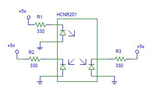

When i had try the optocoupleur, I the schematic in attach fils, and i saw the current in R2 and R3, I had nothing.
The LED is shown the wrong way around in your diagram.
You must keep PD1 as the input to A1 and PD2 to the input of PD2.
