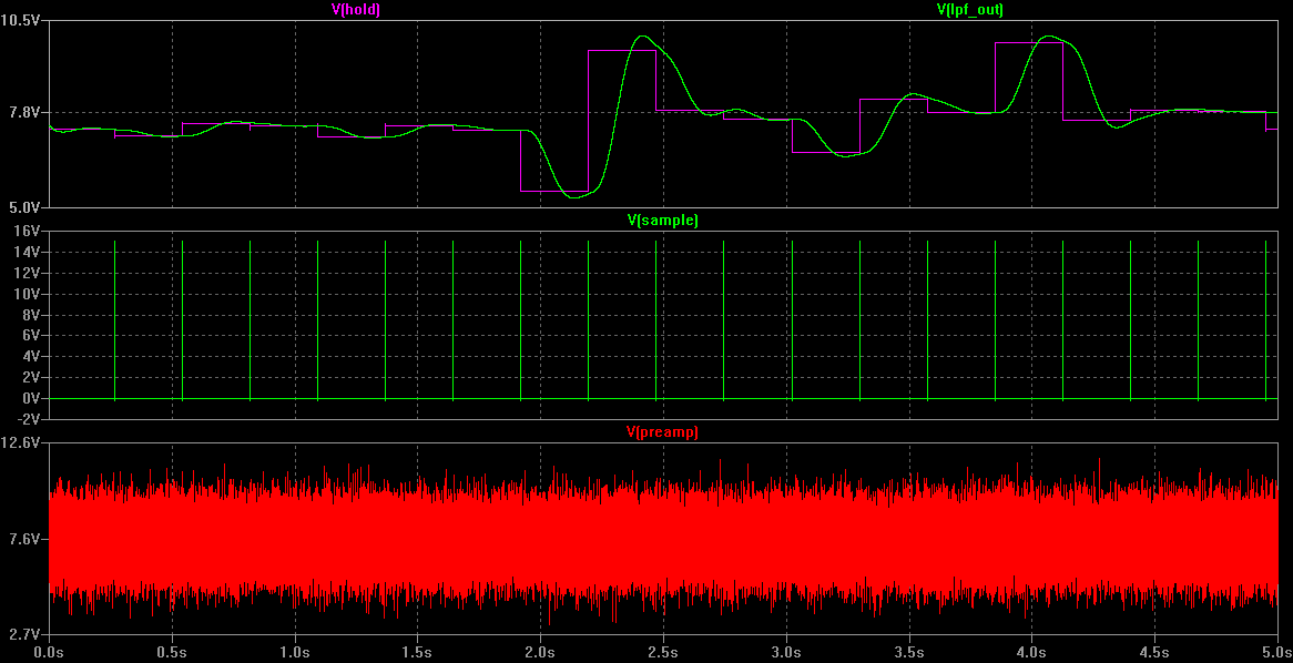

Unfortunately, the performance of the circuit is terrible; the sampled waveform is not the stair-step expected, but a strange ramp/sawtooth shape. (voltage across the sampling capacitor C1 rises and falls even when the current through it is zero!
Simulation results, original circuit:
Simulation results, modified circuit:
Voltage across capacitor C1 vs. current through C1. Note that voltage changes even as current is zero:
What am I doing wrong here? Is there any way I could improve the circuit's performance? Should I pursue some other approach to the 'flickering candle' problem instead?
I would be grateful for any advice.
