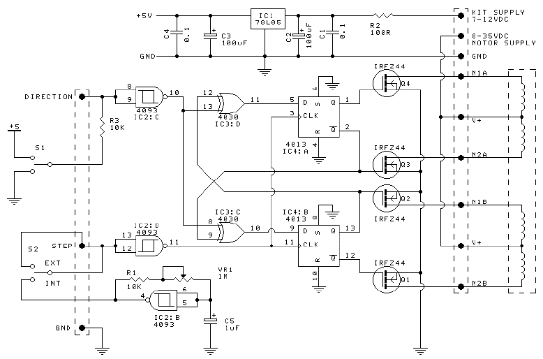

i have searched with no luck, i need to make a stepper motor driver that just needs a analog signal is this posible, this stepper has 5 wires 4 coils.
any drawings? any ideas.

What do you mean by an 'analogue signal'?.
A stepper is just that!, a motor that moves one step at a time, you MUST drive it in that way to move it. You can buy driver chips that generate the required sequence of steps, with simple ON/OFF and CLOCKWISE/ANTICLOCKWISE inputs. Or you can do it quite simply yourself using a PIC.
Without special ICs or microcontrollers you can use digital ICs like in the picture:

by anologe i mean no pwm or anything like that i want to be able to put a voltage in and it will run faster and slower depending on the voltage.
If you use the schematics posted by drrogla and instead of the fixed oscillator use a voltage controlled oscillator, and you have your function.
The only thing you need to make/add is the oscillator. This is the hard fact of stepper motors. You need a lot of discrete electronics to control it.
Or, you could combine the voltage controlled oscillator with the driver circuit in a micro controller. Just keeping the FETs.
TOK ;)
like gorgon said. you just need a oscilator (like a 555) whose frequency you can cintrol, that frequency will controll the RPM of the motor. even with high frequencies you wont get very high RPM with a stepper.
