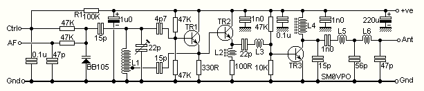

Good news and bad news for me.
The good news is that I can make any sort of transmitter.
The bad news is that it is transmitting on frequencies I dont want it to transmit on!
and whoever invented 1/(2*pi*sqr(L*C)) should go back to the drawing board because it doesn't work for me in all cases.
The following is the circuit I used. (see picture)
I find that if I use the capacitor between base and ground, then I am able to fine tune the transmitter until the receiver picks up the signal clearly.
BUT, I have tried the following, and it interfers with TV station #12 and yet, the station is local!
I tried removing the base-ground capacitor.
I tried increasing the capacitance in the tank circuit further.
I even tried increasing the resistor to 50K and decreasing the cap from base to +ve to 680pF.
I'm trying to transmit audio from my computer.
my computer alone causes no interference.

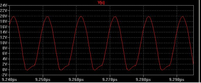

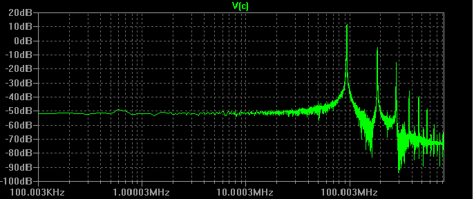

Your oscillator is oscillating around 100MHz, as you probably intended. However, the output is extremely nonlinear (nonsinusoidal), which creates large harmonics at 2, 3, 4, ... times the resonant frequency of your tank. Channel 12 is at 205.25 MHz, and the 2nd harmonic is probably the highest powered one. This is the reason you have to be careful to add a filter between a high-powered transmitter's output and the antenna. Below are time domain and frequency domain graphs of a ~100MHz oscillator which is very similar to yours.

MStechca,
I don't know why you are using a 2N4402 transistor connected as a diode, instead of a resistor.
I don't know why you are using only the collector-emitter capacitance of the 2N3904 transistor, which changes with supply voltage and temperature changes, instead of a small feedback capacitor.

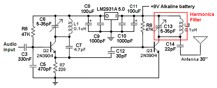

I think (hope) I solved the interference by harmonics problem in my FM transmitter circuit by adding a tuned output RF amp. Maybe Ron can sim it to see. :)

audioguru said:
MStechca,
I'm just setting up a power control. Right now, base and collector of the PNP are grounded for full power. Soon, I will do base of PNP to ground, and then colector to ground.
Sorry, my mom was so mad at me last night for causing interference, I actually forgot to add a 5.6pF capacitor between collector and emitter of the NPN.
The section you highlighted with a red square is what I am using as my tank circuit as well.
Isn't there an extra filter I can add on to cut the harmonics off completely?

That low pass filter set in the circuit is a little strange to me.
I can only tell that L6 and 47p make a low pass filter.
L5 and 56p seem to make a low pass filter. I think 1nF is a coupling capacitor because of its high value. L4 and 15pF is another low pass filter?
Can you please show me all the filters near the antenna? Thanks.
Why? Its function is to reduce harmonics and it uses multiple stages to do its job very well.
Correct, the 200MHz harmonic is reduced to 1/4.
Correct. Together with the other lowpass filter, the 200MHz harmonic is reduced to 1/16th.
Correct.
No, at 100MHz they are in parallel and are a tuned circuit. They are in parallel because the two 1n0 decoupling caps have a very low RF impedance therefore the positive supply and ground are at the same RF potential.
We just finished discussing them. :lol:
Here's the interesting part.
It seems that the 1nF coupling capacitor almost makes my circuit useless. I changed it to 15pF and I have to add a capacitor between + and gnd just to get the transmitter working. Also, with this setup, I wont be able to provide optimum transmitter results with a capacitor connection between base of the NPN and ground.
When I tested everything, it seemed to stop TV interference, however, I turned on the radio which is about 1/2 meter away from the transmitter and flicked through the entire FM band, and came across the transmitter signal only twice.
