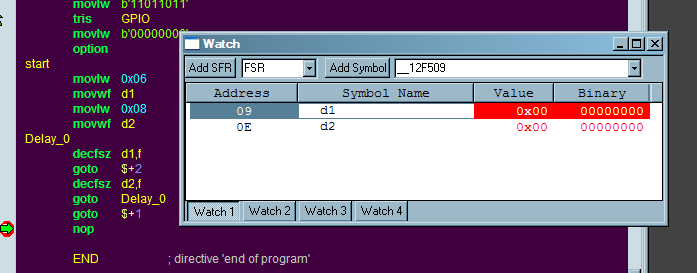

hi John,
Tried your short program using MPLAB IDE 7.6
The MPLAB warned me that that the WDT was active, which I disabled.
With break points at decfsz and the nop [ in the Delay_0 subr ]
Using RUN it would not break at the NOP, until d1 and d2 are zero,,, the decfsz was OK.
Using Animate, with only one break point at the NOP, it stops OK at d2=0
See image.

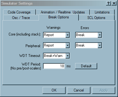

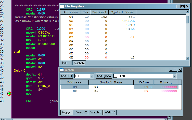

hi John,
Just re-run after lunch, still works OK. image1
It does take a few tens of seconds, real time, to dec to zero.
Are the debugger settings the same as mine, see image2
I'll try it later on my other PC with MPLAB IDE 8.10
