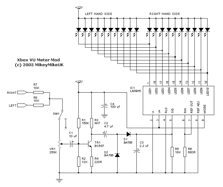

So which brings me to my next project VU meter. Attached is a schematic of a VU meter i found on the internet. I wish i found it back when i was in my modding xbox phase ;). Now This circuit is designed for a "stereo output" RCA jack. I would like to have the flexibility to be able to use it for a mp3, computer speaker, or at the end of a stereo speaker (so i can put the LEDs in the speaker. is there anything i need to change? can i just put a potentiometer to limit the current(although there is already one in there)? I already see that this schematic has constant power and the creator just opens and closes the audio signal. Also, He combines the left and right channels is this going to pose a problem besides it being mono?

1) The LEDs are paired in parallel which is wrong. Two LEDs should be in series for each output of the LM3915.
2) The 680 ohm resistor sets the input voltage that lights the 10th LED and sets the current from each output at 17mA and the MODE pin is high so the IC is in the BAR mode. Since the supply to the LEDs is too high at +12V then if the LEDs are 2V red ones in parallel, when all LEDs are lighted the LM3915 must dissipate (12V - 10V) x 17mA x 10= 1.36W which is its absolute max allowed temperature (it is extremely hot). Even if the LEDs are paired in series and have a higher voltage, i would add a resistor in series with the supply to all the LEDs (and a bypass capacitor as shown in the datasheet) to share some of the heat.
If you use a "16V" door bell transformer then it makes a rectified and filtered 21V to 26V supply which is much too high. The circuit needs only 6V to 9VDC depending on the LED voltages.

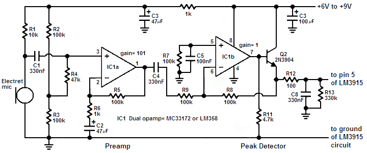

The "peak detector circuit" made with the transistor's collector resistor charging the capacitor following the rectifiers has an attack time that is too slow. In my VU meter I use an opamp instead of the transistor and it drives an emitter-follower transistor that charges the capacitor very quickly. My opamp is a single-supply type so it automatically rectifies without the rectifier voltage loss of your circuit.
This is my preamp/peak detector circuit:
This circuit has a lot of problems with it. The bigest one as audioguru has pointed out, is that the LEDs are in parallel and not in series. The second problem is that it mixes the left and right audio signals together. It would be better if you could take an LM3915 and just make 2 of the same circuit for you purpose. You will need a peak detector if I'm not mistaken (I don't understand why though please elaborate if possible).

Thanks for spending time looking at the circuit. There is a reason for both sides being connected in parallel and that is that they are all doing the same thing. Putting them in series would create a voltage drop and both LEDs wouldn't be the same brightness. **broken link removed** this the project i am attempting minus the xbox. I do agree 12volts seem high though. I believe the ic needs to be in bar mode to perform its function, because only one LED would light if it wasn't.
Wrong!
The outputs of the LM3915 have the current regulated so voltage drops of the LEDs do not change the current.
Since each LED has a different forward voltage then in parallel one will be very bright and might even burn out and the other will be dim or not lighted.
Leds control the brightness with their current, not their voltage so when they are in series then their currents and brightnesses are exactly the same.

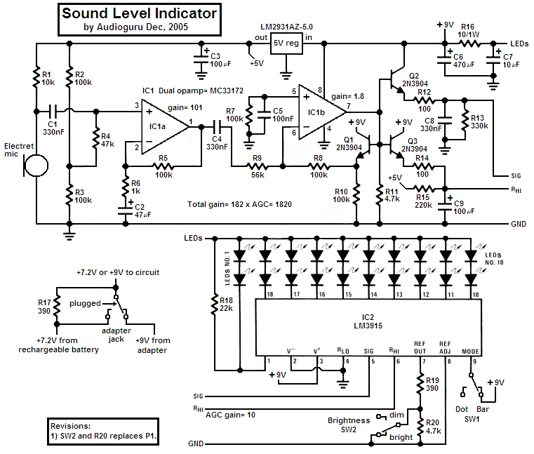

This is my schematic:
nice schematic. seems simple enough. just curious why didn't you include diodes in your circuit to limit the direction of current flow (esp having the battery attached to the same circuit as the charger)? What program do you use for your schematic? is it eagle or electronics workbench?
The charger charges the battery then trickle charges it most of the time. The charger also powers the circuit whenever it is not running on the battery.
I use Microsoft Paint program to make all my schematics and to correct mistakes on schematics posted by others on these forums.
I copy and paste parts from other schematics and from datasheets.

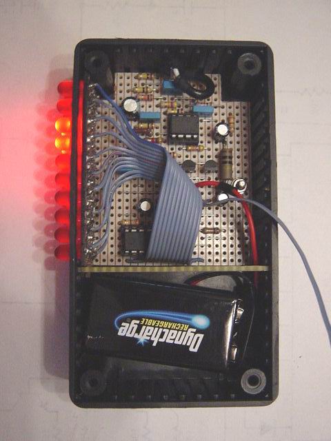

I make most projects on stripboard (Veroboard). Here is the inside of my VU meter showing the DOT mode:
