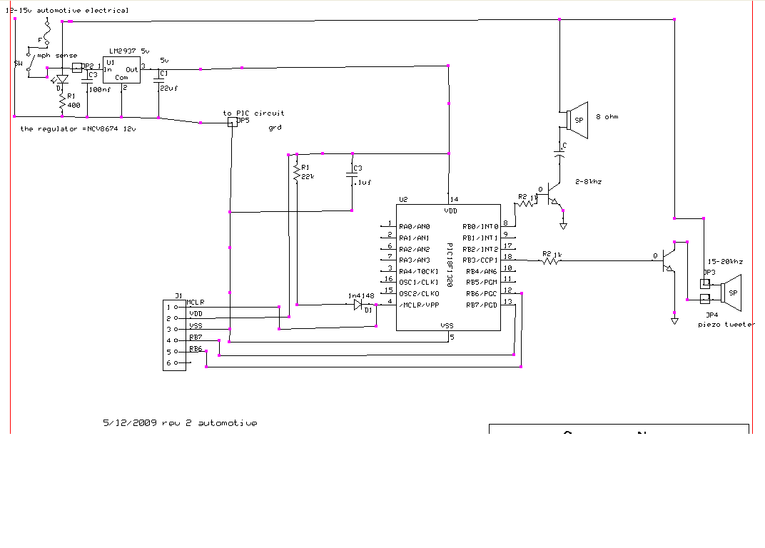

Well so far my critter ridder deer repellant seems to work Need to get the Mosfets instead of using transistors. The base resistors get hot quick.
Now another pest (BATS) in church steeple.
Planning on using a pic that outputs varying frequencies but driving the tweeter.
Don't need much of an amp and beside this unit will be running 24/7 so the push pull amp will surly get warm?
how to safely power a tweeter using the pic output.
Thought about using just a 555 but want the variying frequiencies.
maybe just a 2n2222 on output?
The schematic with two transistors, I will only be using one
The mosfet amp I think is before reversing the mosfet input from Vdd.
Hopefully the one 2n2222 will work. Inserting a resistor to limit current as the piezo tweeter has no resistance?
any suggestions

Your transistors will do nothing because they do not have a DC load.
A single NPN transistor needs to have a collector resistor from the collector to the positive supply voltage. The resistor will waste a lot of power making lots of heat. The transistor will not have enough base current from the PIC to drive an 8 ohm tweeter because the collector resistor will be about 8 ohms for half the power to go to the tweeter then the peak collector current is about 3A and the base current must be 300mA.
The max allowed output current from a PIC is only 25mA.
Going to use a piezo tweeter
Then why does your first schematic show an 8 ohm tweeter and a piezo tweeter??
The transistor needs a collector resistor to the positive supply because the piezo tweeter does not conduct DC current.

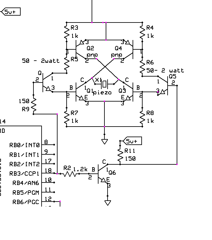

The push pull amp you posted WORKS great
but the base resistors get HOT!

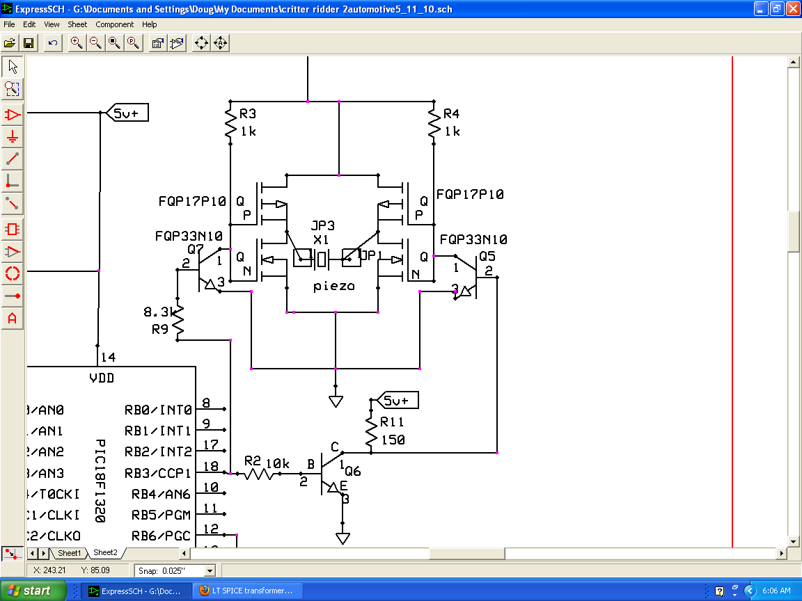

Contemplating this amp
https://www.electronic-circuits-diagrams.com/homegardenimages/1.gif
here is the mosfet circuit you suggested. Not sure if this has correct source connections. Need to check. I recall you mentioned I had them backwards but not sure the posted schematic here is correct?

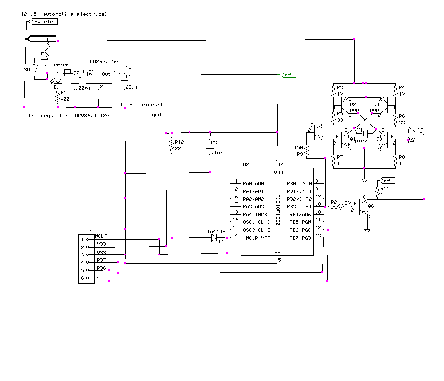

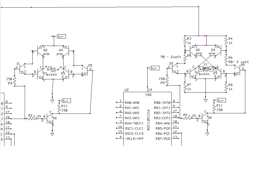

Which resistors get hot? Every transistor has a base resistor.

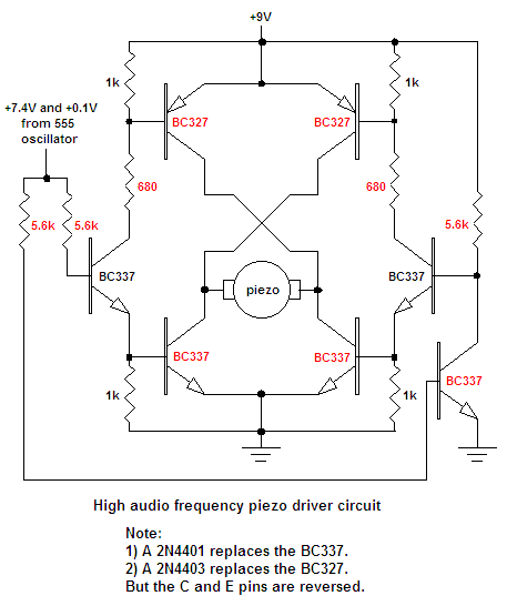

The 33 ohm resistors pass 348mA for half the time so they dissipate 2.0W. Their value is low because the H-bridge circuit had its part values caluculated to drive a 3A motor, not a low current piezo speaker.
All the Mosfets are backwards.

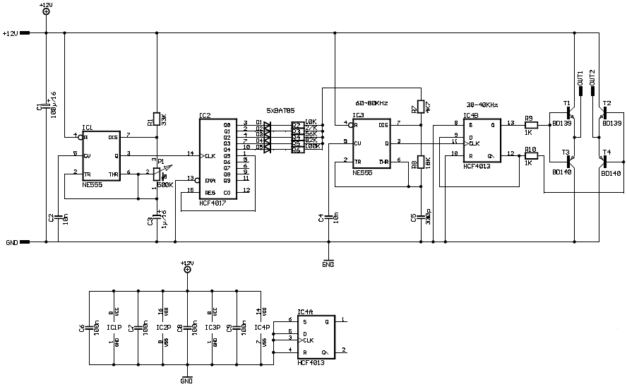

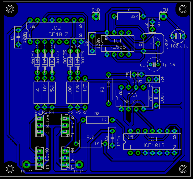

Hi MrDEB,
may be that circuit (with minor changes in frequency) will do the job.
I made it about two years ago for a friend of mine whose car cables were regularly eaten by a marten.
Timer 1 switches the outputs of a decimal counter with different resistors connected to sweep through four frequencies from 60 to 80KHz generated by the second timer. The 4013 divides the frequency by 2 to result in 30 to 40 KHz.
You should use a strong tweeter at the output - otherwise --> poof.
The board is purlely single sided and measures 65X61mm (2.575X2.4inches).
Boncuk

Boncuk's circuit uses a Cmos logic IC to drive the bridge transistors with 13V pulses that are not available from a PIC.
My h-bridge circuit uses 33 ohm resistors and yours uses 50 ohm resistors. Of course they get hot, their value is low enough to drive a 3A motor.
I can't remember the spec's for your piezo tweeters (no-name-brand, no spec's?) but their high frequency current will be much less than 3A so the 33 ohm or 50 ohm resistor values can be increased maybe to 1k ohm and then they will dissipate only 0.07W each.

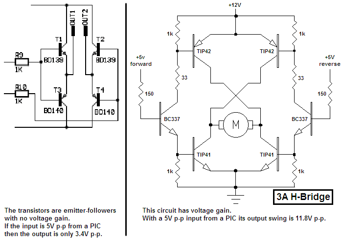

Looking at Boncucks circuit compared to one Audioguru posted.
Basically the same?

Mr DEB,
Frequently, I wonder if you know anything about electronics.

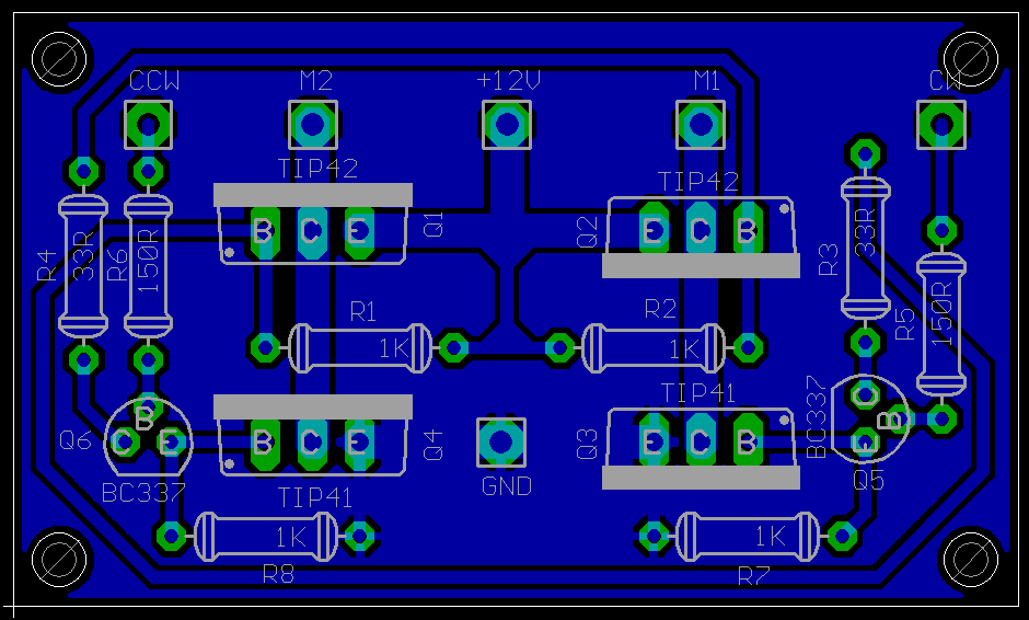

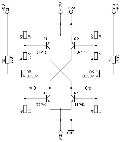

Hi MrDEB,
here is audioguru's H-bridge again, this time including a PCB layout - single sided, as usual. :)
Board dimensions are: 54X32mm (2.1X1.3inches)
I guess a 3A H-Bridge is 100 times overkill for a pest repeller. :D

I have a 555 astable running on 5 volts. Using the amp that Boncuck posted and connecting to 9v to power the amp it amplifies the signal. Need to measure output voltage but my estimate it is 3x louder that just the 555 output.
The H bridge that Audioguru posted works GREAT but need to go with Mosfets as the base resistors R5 & 6 get very hot (2-100ohm 2watt resistors in parallel.
Will try subbing with 1K resistors. Hopefully they won't get hot.Not needed using Mosfets.

Maybe you forgot to add the transistor inverter that drives one side of the H-bridge like this:
