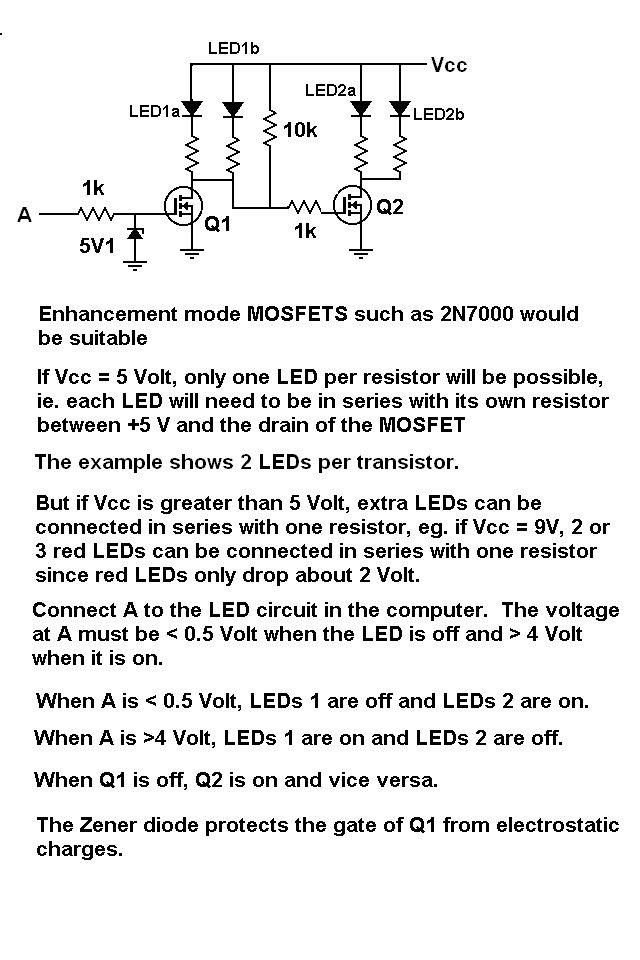

I've done some more research on relays, and found out that they have fairly low lifespans. Considering that my device will be switich on and off about once a second, I need to find something else.
What I want to do is when a small voltage is applied (less than 6 volts), it connects one circuit, and when voltage isn't being applied, it connects another circuit. Exactly like a SPDT relay, except it can't be a relay.
If anybody could direct me where I could learn more about PICs, or what exactly I would need to do this, that would be great.

What's your load like? You could use a transistor.
As Nigel we need more info. It sounds like a simple switching issue.
Easy to do in hardware, probably no need for a PIC.

It's the HD light on the computer - about 4-5 volts - which will be triggering the relay type thing.
When the HD light is supposed to be on, it's going to trigger one set of LED (inside the case - i've got a fancy nice little window cut out) - lets say red LED's.
When the HD light is supposed to be off, it's going to trigger a different set of LED's , lets say orange LED's.
The sets of LED's only take between 3.2 and 3.8 volts to power them - both of the voltages are extremely low.
So, the idea is, that whenever there is HD activity, two colors of lights will be flickering on and off inside the case.
- All just like a SPDT relay.

Here is a suggestion for you.
Select the resistors in series with the LEDs according to the brightness you want.

Len, I think you should add a resistor (10k maybe - not critical) from Q1 drain to VCC. Otherwise, the gate of Q2 will take a long time to reach VCC.

Yes, I was thinking about that myself. It depends on how much voltage is across the LED (or LEDs) when they are on. All that charge has to drain away.
So I have revised the drawing.

Okay... By the description underneath the drawing, it looks like that's exactly what I want, but I really don't understand how it works... Do you think anybody could explain exactly what's happeneing in the diagram?

When A is low, Q1 is off so its drain is at +5 Volt (LEDs1 are off), thus this voltage is applied to the gate of Q2.
This turns Q2 on and so the LEDs2 glow.
When A is high, Q1 is on (so its drain voltage is small), LEDs1 glow and the gate of Q2 is low and so it is off and LEDs2 are off.

You will have to search for a similar transistor to the 2N7000. It is not critical. N channel MOSFET with adequate voltage rating and current rating for Vcc and the LED currents.
