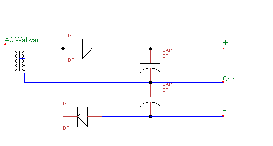

You could use 2 DC wall warts. The more elegant warty method would be to use one that puts out AC. Then rectify it to give you both polarities:
posneg-png.32813
You may want to follow with pos and neg voltage regulators to eliminate any ripple on the output of the supply.

Edit: I took a closer look at you power supply schematic and i like it much better. Its probably a lot simpler than using the 78xx. However, how would i go about calculating the values of the caps and diodes? I'll probably be able to figure out the regulators.
Thanks for your help, btw. :D
First you need to decide how much ripple your circuit can tolerate. If you want really low ripple, you'll need a couple of regulators after the caps. A 7809 and a 7909 should work out OK. If you use a 10VAC transformer or wallwart, you'll get apx 13.5V which gives just enough headroom for 9V regulators and a bit of ripple.
The formula for ripple is::
Vrip = I/F*C
Where Vrip is peak to peak ripple, I is the load current in amps, F the frequency in Hz, and C the capacitor in farads. This formula is only an approximation, and thus the actual ripple will probably be lower. Try a couple of 4700uF, 25V caps. Any of the 1N400x series diodes should work for this project since the max current is low at around 250ma or so.

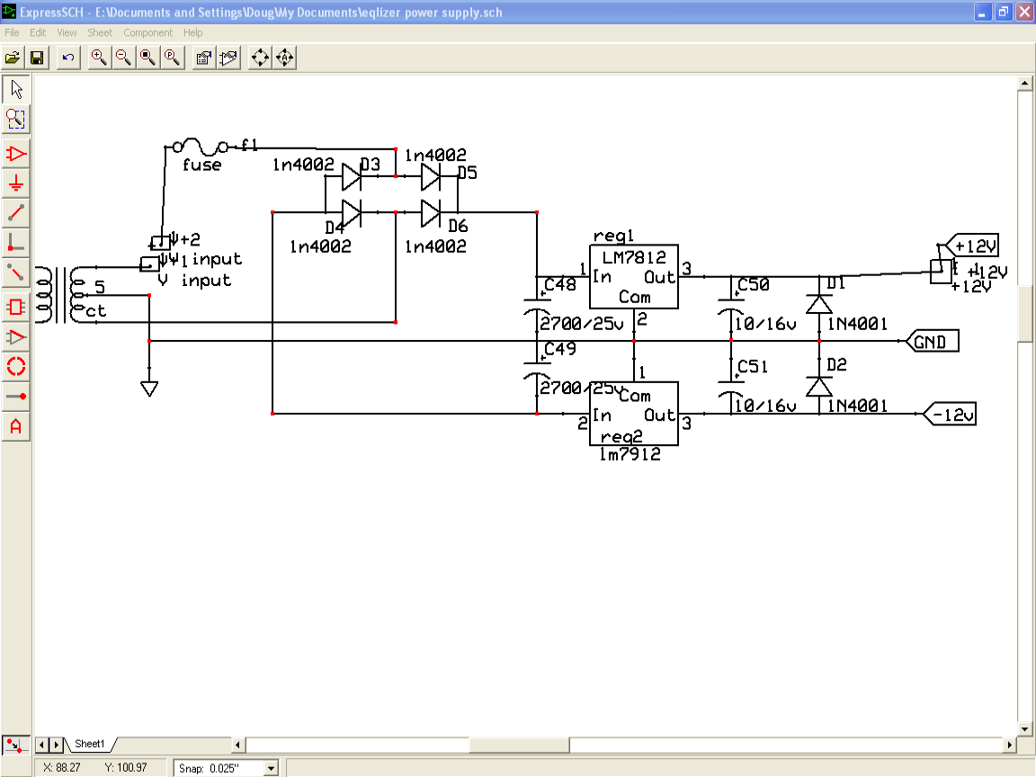

here is the power supply I plan on using

kchriste - I have a few transformers and diodes lying around, so i could get some caps (not a big deal) and try it out.
MrDEB - I have expresspcb. if it wouldn't be too much trouble, i'd like to take a look at those schematics :)
I can PM you my email address if you'd like.

If you have a transformer with a center tap, then MRDEB's supply is a better one. If not, my diagram will work fine too.
I would probably end up using MrDEB's schematic anyways since it already has the voltage regulators laid out. I haven't started building this yet so it would be a while before i would post results.
