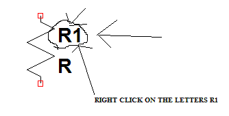

Another question about SwitcherCad
real simple . . . just right click where it says R1. itll come up w/ a window that says "enter new reference designator for R1". then just change the name from R1 to Rp :lol:
That's what I thought, but the window that comes up is to change the value, tolerance or select a resistor from the database. I have accidently had the window come up to change the designation, but I don't know how to make it happen.
what you're doing russ is clicking on the resistor i think.
sory russ, i wasnt clear enuf, right click on the LETTERS R1!! like in the picture, i dont think it gets much clearer :lol:
