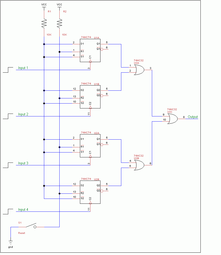

i need help with a buzzer circuit. i have 4 inputs (mayb more, but once i get the 4 workin it shudnt be too hard for me to expand it) what i need connected to a buzzer. what i need is whan an input goes high for the buzzer to sound until a button is pressed, but i need the buzzer to then stay off whilst the input is high, and not sound until the output goes low then high again. the harder part is i need it to sound once another input goes high, even if another input is high.
does any1 know how this can be done (pref using logic, not microcontrollers) or or can give me any advice on how it can be done?

You need edge-triggered (as opposed to level-triggered) logic to do this. You'll probably also need to debounce the inputs and buffer the output. Feed each (debounced) input to the clock pin of a positive-edge triggered D-type flip-flop (1/2 of a 74XX74, tie the "D" and "Preset" inputs high). Feed the outputs to an OR gate (a 74XX32 wired properly will substitute for a four-input OR gate). Tie the "Clear" lines of the flip-flops together with a pullup to VCC, and place the pushbutton switch between this node and ground. Two 74HC74's and a 74HC32 would be enough for the logic function.
On second thought, the inputs probably don't need to be debounced. Multiple high-to-low transitions at the inputs due to switch bounce won't change the flip-flops' state after the first low-to-high edge. Only pulling the "Clear" line low will.
er... could someone please repeat that in english? (or make a lil bit more simple to understand). any1 have any diagrams?

Sorry about that, Andrew. Didn't really have time to draw it up last night. The attached schematic should help. You could also substitute a 4-input NAND gate like the 74HC20 for the multiple 74HC32 OR gates, as long as you use the Q' (not) outputs from the flip-flops instead of the Q outputs to drive the NAND gate inputs (A NAND gate is equivalent to a negative-logic OR gate). It depends what parts you have on hand, either way it's the same package count.

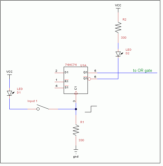

yet another question. for the input, i need power to flow back to ground, allowing the LED to light. could the input be connected to ground via a resistor allowing the input to the buzzer circuit to read the 'high'?
It depends what you want the LEDs to do. If you want the LED to only come on while the input's held high, then yes. The R1/D1 connection in the schematic below shows how to do this.
If you want the LED to come on and stay on until the reset button is pushed, you can use the flip-flops Q' output to drive the LED, as shown with R2/D2 (You'll need to calculate the resistor values for your LEDs).
There's a potential problem to be aware of when using LEDs on input circuits like this. The forward voltage across a LED is typically around 1.6 - 2.2V (depends on LED color and other factors). If resistor R1 was connected to VCC and LED D1s' cathode to ground, the voltage across the LED may not be enough to guarantee a high TTL level. That's why the schematic shows R1/D1 swapped from their usual positions. Connected this way, the input sees the voltage drop across the resistor (VCC - Vf) instead of the LED's forward voltage. This should be over 3V with red, green, orange or yellow LEDs, and is enough for a TTL high level.
Since the first method depends to some extent on the forward voltage of the LEDs, the second arrangement (driving the LEDs from the flip-flop outputs) is preferred. In fact, if you were using a blue LED, you'd probably have to switch the positions of R1 and D1 back again, due to the high Vf of blue LEDs (~ 3.7 - 4V). Not great from a design standpoint.
