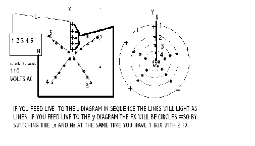

THE NEXT STAGE
The diagram is fine BUT stop at the triac 100 VOLTS AND before the lamp.
I'm looking for an add on circuit to switch polarisation.
I NEED TO MAKE THE LIVE NEGITVE AND THE NEGITVE LIVE
I could use a relay to switch LIVE & NEGITIVE but wondered if there was another way using triac type switching so I don't have to use relay's
TRIAC == {LIVE TO NEGITVE SWITCHING AND VICE VERSA} == LAMP
IT COULD BE I STILL HAVE TO USE A RELAY TO DO THIS BIT BUT WONDERED IF THERE WAS ANOTHER WAY.
TO DO MAINS SWITCHING ?

The only sensible way would be to use a relay, but (more importantly) WHY do you want to this?.
Mains is AC, and not polarised - the two wires are LIVE and NEUTRAL, not positive or negative - the only difference is that the neutral wire is grounded at the substation, and is the common wire for three phase.
Why do I want to do this!
I have wired up some light boxes in this case 110 volt Ac
five circles,
going in and out, off the controller (a starburst) fx
I have wired them so if you swap all the feeds over at the same time
You get a cartwheel fx
Now you know why!
Is there another way with out using relay's
freddie
If I understand you correctly you want to have a control input that switches all the lights that would be on, off and all the off lights on. If this is what you want you should switch the control inputs not the triac circuit. An XOR gate will allow you to have a input that inverts (i.e. changes the on signal to an off signal and vice versa) the control signal.
I think the words you are using are confusing people. Live and negative are words used for two different things so when you put them together its quite confusing. The triac circuit lets you switch the lights on and off - if you stick to the words on and off for the lights, and high (positive voltage) and low(0 V) for the control signals people will understand you much better.

No! - I don't see how swapping live and neutral would make any difference at all?.
If you wanted to swap individual chains of lamps to a different output it might make a slight amount of sense - but you've never suggested that?.
drawing
I'm not too good with pictures
two lighting fx'x from one box by switching
First fx starburst
seccond fx lines
