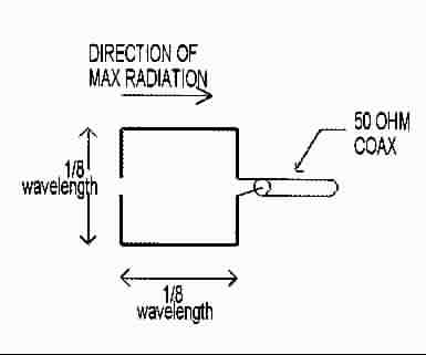

A simple antenna can be made if the frequency is VHF or higher, I got this design from the ARRL antenna Handbook, I have not built it:
I have the 315mhz version of the transmitter and receiver. It says on the datasheet that the antenna can be made totally on the PCB.
Anyway, I'm just going to try a few things on the test setup and see if anything works. I'll buy a matched antenna if I put it into an actual design. In the meantime I'll try to read up more on what this all means.
