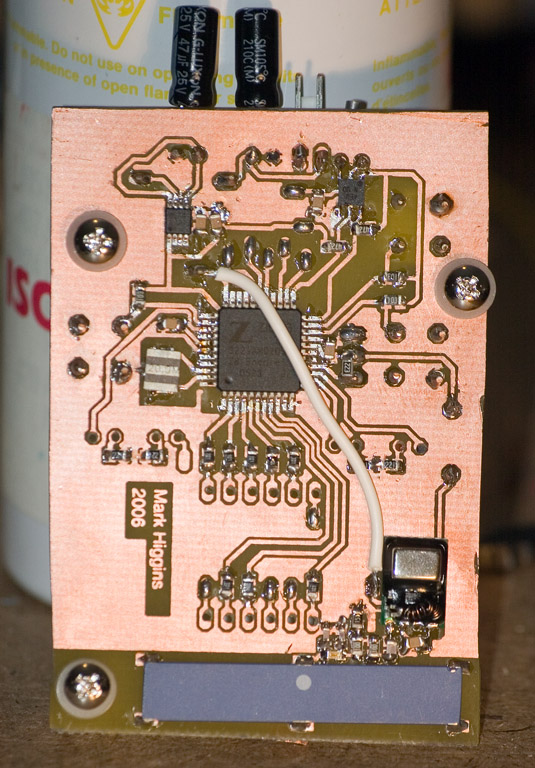

Antenna design is a magical art that is beyond me. I've used these 433Mhz chip antennas in the past. I got them from Mouser.

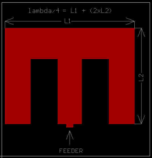

Here's a PCB-antenna as it used with a MICROCHIP transceiver. The dimensions are lambda/4.
The feedline does not add to antenna length.
Maintain a top trace keep out area of 0.21X0.2 inches at the feedpoint.
Details shown in attachment.

Mark, Which piece of the board is the antenna? The grey component at the bottom of the picture?
The chip is at the bottom, and it's actually a light blue-ish. It's beside the transmitter and SAW filter. It's a Yageo part. Checking on Mouser and Digikey, they have the parts listed, but they aren't stocked. The only other alternative chip antenna is a Linx part from Digikey. Part #: ANT-433-SP_
