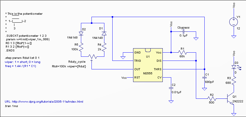

Hi BL,
Just another thought. In order to get around the potential for trouble with the short monostable pulses in my above circuit, I've just modified a simple 555 PWM circuit from **broken link removed**
This version uses only one 555. The output frequency is not completely stable but it does stick fairly close to 10kHz. In the simulator it varies between 9.4kHz and 9.6kHz. The 100k pot adjusts the duty cycle and R4 and R5 limit the duty cycle from ~1% to ~50%. Again, I can't guarantee the stability in the lower end of the range; perhaps one of the real gurus around here can answer that question for you. If it's not a suitable solution you may have to look at another IC to handle the task.
Again, hope this helps!
Torben

I am using your 555 (NOT the 556) circuit above. This is being put in an auto, it is driving a single throttle body injector, so not much current, but unsure of exactly how many mils.
OK, I have absolutely no experience with driving those. Sorry. If I had to guess I'd say beef up the output transistor (to maybe a TIP31 or bigger), and either invert the signal with another transistor before the output transistor or use a PNP (TIP32). At this point I should warn you again that I am officially guessing. :) Or else swap the timing resistors in the 555 circuit so that you're using the other half of the duty cycle (i.e. 51% to 99% instead of 1% to 50%)--but I would still look into using the bigger output transistor.
Do you have the make and model of the injector? I've found some forum posts about hotrodders using 555 PWM circuits to drive their injectors but haven't really dug much deeper than that.

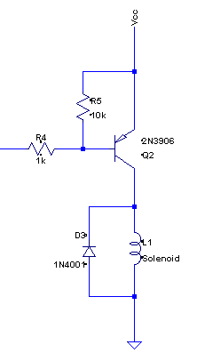

No, I dont have any model on the injector, but it cant draw much current, I would be surprised if its more than 10 mils. Do I need to do anything else besides replaceing the npn with a pnp?
Well, if the thing really is only going to draw very little amperage (by 'mil', do you mean 'mA'?) then what I would do to invert it is shown below. As long as the PNP can handle the solenoid current it should be OK. I just used a 2N3906 in the simulation since it was available; you might need something bigger (although for 10mA the 2N3906 should be more than adequate).
I'm no expert but I must confess I'm a little skeptical that the solenoid draws under 10mA. ;)
I've added a resistor to the PNP to ensure that it's completely turned off when it's supposed to be. I've also added a protection diode in reverse-parallel across the solenoid, in order to keep any back EMF from kicking back and cooking the transistor when the solenoid is turned off. Your solenoid might include a protection diode; I don't know how common that is. I've shown a 1N4001 which I would think is a bare minimum; I don't know whether you need higher or not (i.e. 1N4002 or such).
Hope this helps,
Torben
