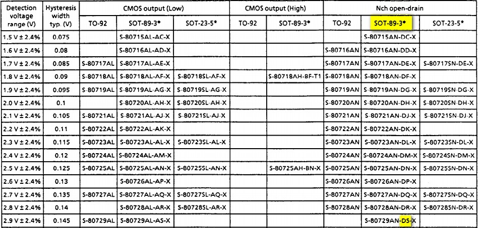

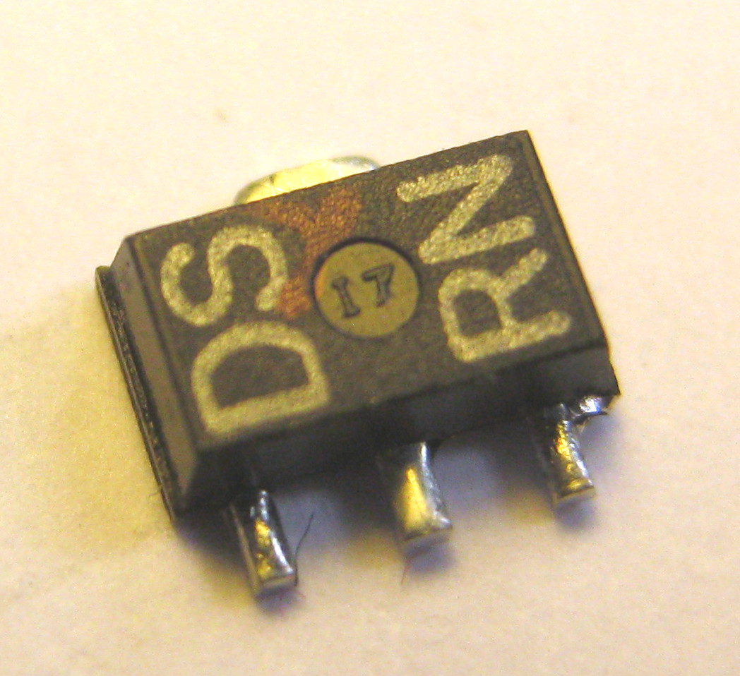

Not a very exciting mystery object, but can anyone help my identify this component?
I *believe* that it is an NPN transistor - it measures correctly for an NPN with a meter (ie, two diodes pins 1>2 and 1>3), although I've not been able to put one on a component analyser yet. I believe the package is a SOT89.
It is from a voltage-controlled-amplifier, which features a large number of these components (at least some of) which are connected as trans-diodes (that is, pins 1 and 2 shorted).
One of the devices has failed, and I would like to replace it - in reality, I suspect I'll need to replace all of them to ensue a good match.
This one (the borken one) is marked "DS RN", although some others from other modules are makred "DS RM", so I suspect the "RN" may be a batch or date code.
I've looked everywhere I can think of... any help really apreciated!

SM components are difficult (and often impossible) to identify, stick it on a component analyser to test it as it could just as easily be a double-diode, which are fairly common.

I doubt it is a double diode because of the thermal tab. (I can be wrong, check the gain on a transistor tester.)

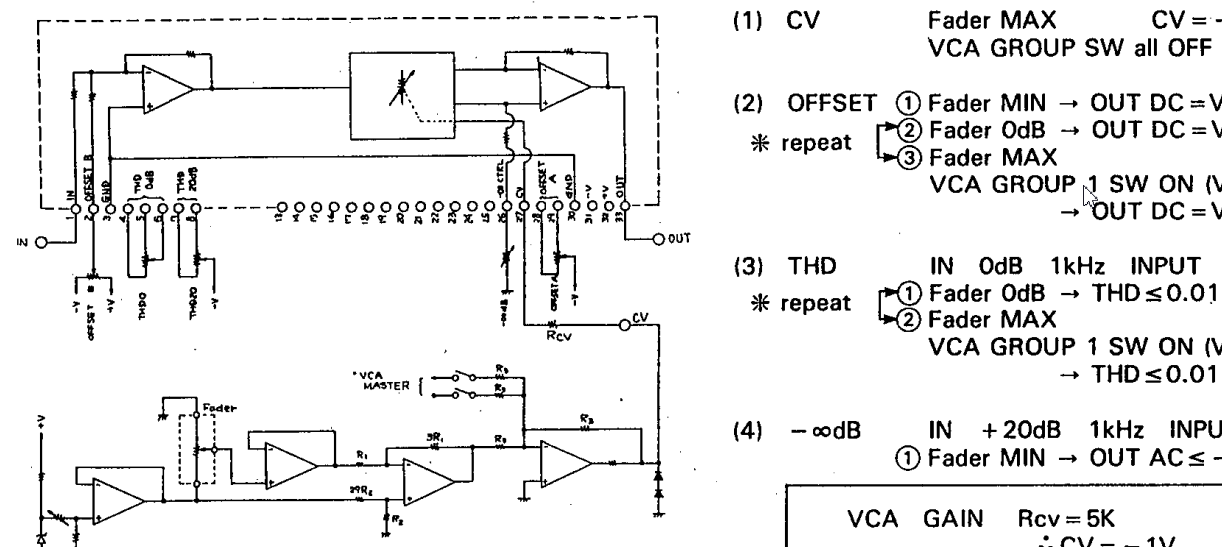

The full story is that the circuit in question is a VCA module from a Yamaha PM3500 mixing console - there is one per channel. It's a small circuit fabricated on a ceramic substrate (although I don't think it would be right to call it a "hybrid" as it's all packaged components, and no resistors on the substrate that I can see). It is soldered into the main channel board with a single row of pins. I have a service manual for the console, but the VCA module is just marked as an IC, with no reference to what it might contain. At least the manual does give me the input and ouput signals. It wouldn't be the end of the world to trace it out, but I'm not sure it would gain me anything.

You mentioned about having a service manual. I believe what you are pointing to is the VCA hybrid IC XK868COO which was manufactured by someone other than Yamaha(Murata.TDK, etc).
Surprisingly, Abtronics.Ru has it still listed on line.(have never dealt w/them):confused:
A 33 pin inline IC. Yamaha was always good about showing at least a block diagram of the IC's on their equipment(A long faded practice)
Look at page 49 paper (42 of the PDF) and there is a block diagram of that hybrid.
BTW, instead of SMD resistors, most were etched on the substrate IC.
Hope that helps
Thanks vtech, very interesting.
I must admit that I'd not found that block diagram but, yes, that's the part (those two op-amps are NE5532s). Those manuals are exquisite - as they are for most of the Japanese gear that I've seen, even the later stuff.

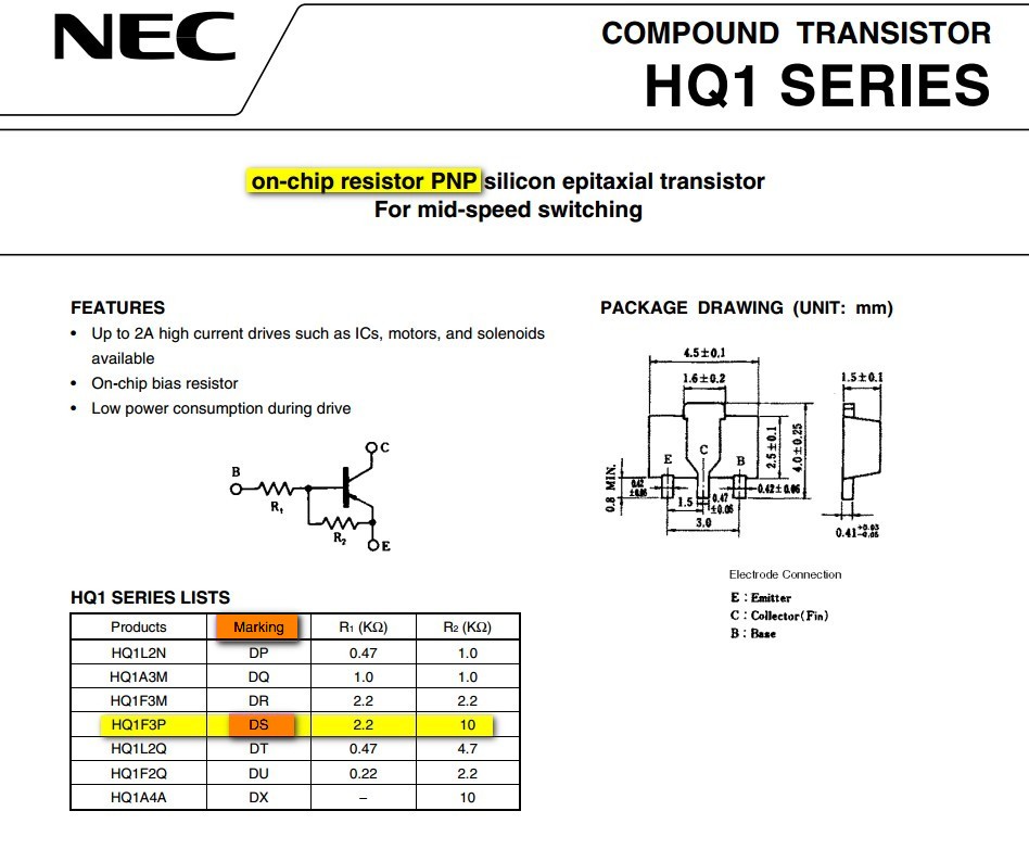

Some meters measure resistance at low voltage (<1/2 volt) and you can see the B-E 12K resistance.
Some meters may need (reverse the leads) to see 12k.
From my experiance the ratio of R1/R2 is very good (1%) but the resistance is +/-20%.
