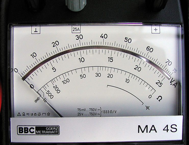

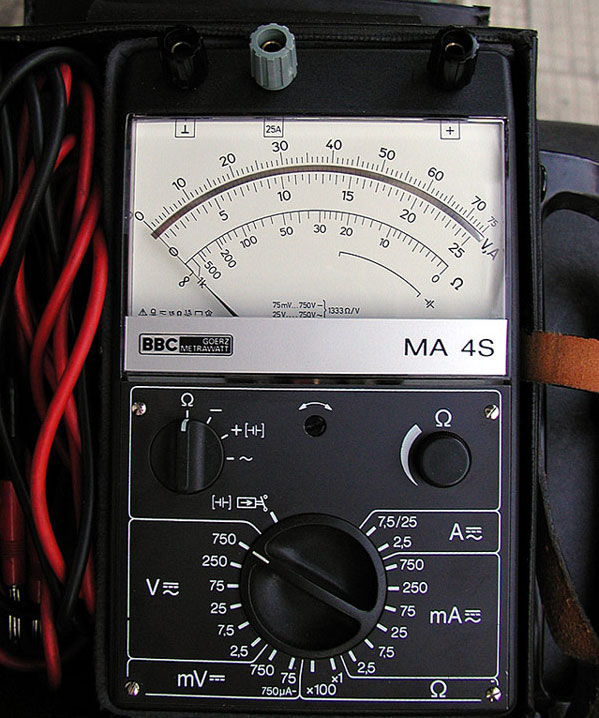

I changed my opinion last year that I found on Ebay one German made BBC Metrawatt MA4S.
My hobby is to repair digital photo cameras, and I needed one high quality analog,
so to be able to measure the battery consumption, and to identify problems in the cameras power boards, who causes a quick drain of the batteries.
The digital DMM was too fast or too slow, to capture small changes.
