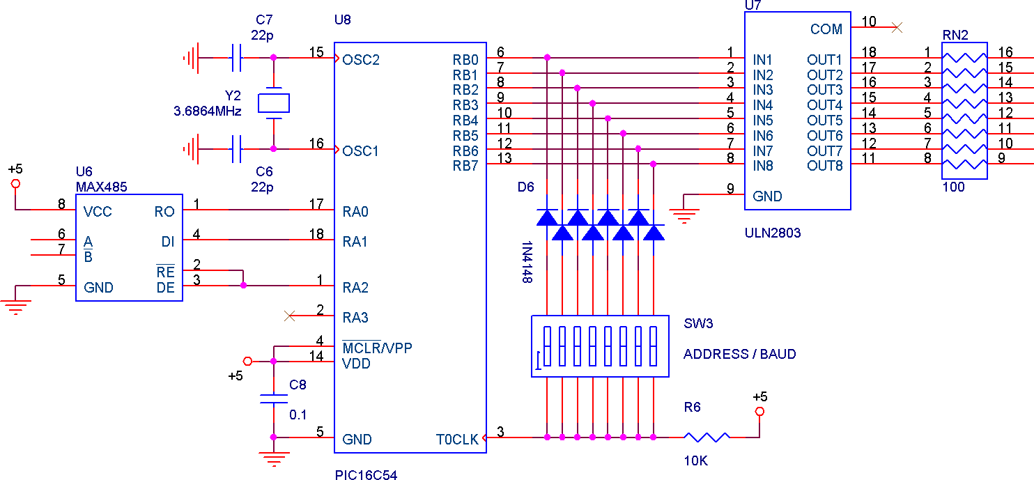

Any reason not to use a 16C54?
I have a simple project in mind and although I'm a big fan of the 16F628A as it's cheap and a great chip;but I simply need a basic non reprogrammable micro. The 16C54 fits the bill. All the I/O I need for the project I have in mind and it's cheap too. $1.48 at mouser.

Don't forget, you have to include the cost of the crystal for the C54, the F628 has an internal 4MHz oscillator - which probably makes it cheaper to use?.
As you're obviously aware, the C54 is a seriously old chip! - you also have the big expense of UV eraseable versions for development.

I'm lookin' at the 16C54C Data Sheet and it looks like it's a 12-bit core with very limited resources compared to the '628A... Hardly worth the 30 cents savings if you were buying them...
Heck, if you've got a bunch of them on hand, you might as well use them...
BTW, I agree with Nigel... The 1% tolerance 4-MHz and 8-MHz INTOSC in many PICs provides very reliable serial communications as long as you avoid severe temperature extremes... And using special 1.8432, 3.6864, 7.3728, 9.2160, 11.0592, or 18.432-MHz "UART" crystals seems almost silly when you look at the bit rate errors for standard crystal frequencies -- even more so when using newer PICs with 16-bit SPBRG capability...

It will be in a pretty broad temperature range, outdoor, Canadian winter.
If you're designing for a production run of less than a few thousand units, the cost savings is not worth the pain.
If you are designing for a run of tens of thousands of units, there are also pic16c54 clones out there.
The PIC16C54 is still available because there are existing applications developed in the last century that are still in continuous production.

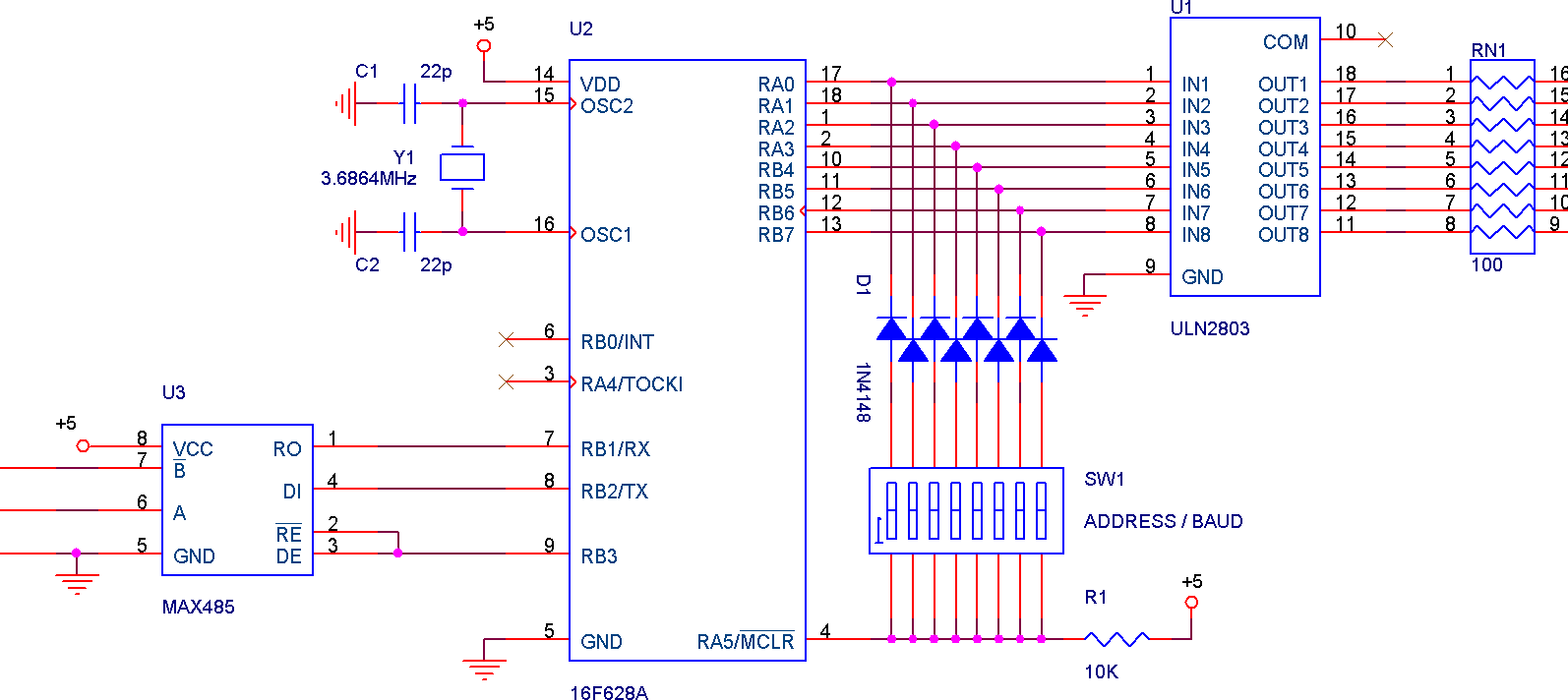

Well I took the advice of this thread, sniff I'll miss you little 16C54; but I'd miss a hardware USART, IRQs & Internal OSC more.
I've used a 16F628A in the attached schematic, the crystal will be optional (internal or resonator)
Now what to do with my favourite I/O pins (spare)
RB0 has an edge trigger IRQ
and
RA4 has an open collector output (great for iButton stuff)
