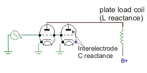

After reviewing the excerpt from my last post, yes Ron... grammatically I used "the" B+ path and “the” load coil instead of "a" path or load. Perhaps this precluded a general block diagram from being conceptualized in favor of a specific schematic I was not letting you be privy to, although your phrasing of “a” schematic may indicate you gravitate to schematics instead of mental models, fair enough Ron. Here's a quick rendering of the block model- see Attachment
Adding another tube in parallel changes the sum value of plate to cathode capacitances... say 10Pf to 20Pf... reducing the reactance by half in that stage of the network. The other stage being the plate coil.
What do you think!
Vince

Well, parallel tubes do increase capacitance on the plates, and they will also draw twice as much current (DC and AC), but as I understand your problem, it's a DC voltage problem. Since the load coil presumably has negligible DC resistance, the DC plate voltage on each tube is the same as before. Now you have two tubes that may overheat, or arc, or whatever.
I think cascode might work, although you might simply use a resistor between B+ and the load coil, with a bypass capacitor to ground from the junction of the resistor and the coil.
Is this an RF circuit? If so, what is the carrier frequency?
BTW, I believe the interelectrode capacitance is primarily from plate to grid. The grid shields the plate from the cathode.

The purpose of the screen grid in a tetrode is to reduce the (Miller) capacitance between the plate and the control grid, allowing higher bandwidth operation. The cascode triode configuration has the same effect. You shouldn't need to use tetrodes in a cascode circuit.
Having said that, I'm guessing that you have a schematic which uses a tetrode, and a power supply whose voltage is too high, and you don't know enough about tube circuit design to get the two together. Post a schematic and maybe we can come up with a sensible solution.

Vince, I can answer your questions, but I don't think the answers will get you closer to the solution to your problem. Do you have a schematic that you are starting with? I can't believe you are designing an RF amplifier from scratch. If you do have a schematic, post it. Otherwise, we'll just beat around the bush here for days.
