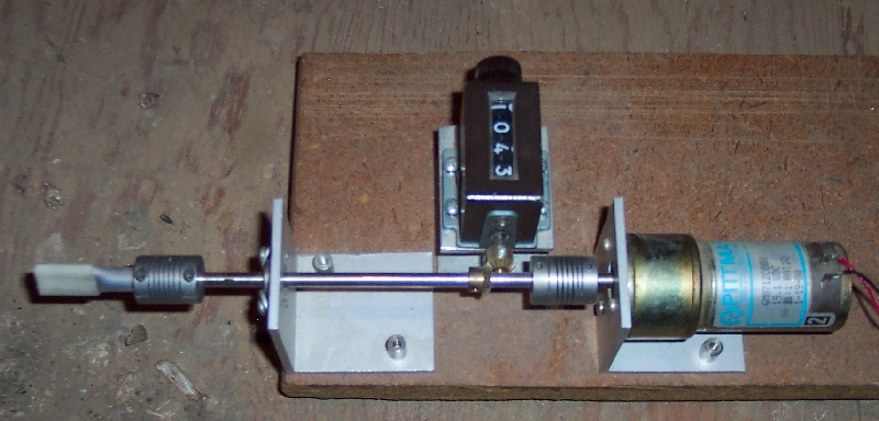

A sowing machine motor and foot pedal works well for me. Because it takes hands to feed the wire into the bobbin correctly I like using my foot to control the speed. A counter is important.
Small machine: gear motor, 200 to 400RMP???, counter, shaft with interchangeable tooling.
Each type of transformer uses a different tool to hold it in place.
winds coils and transformers up to about 1.5 inches.
Uses a bench supply. Set voltage for speed and current limit for max toque.
Can stop the motor by hand and the current limit cuts in.

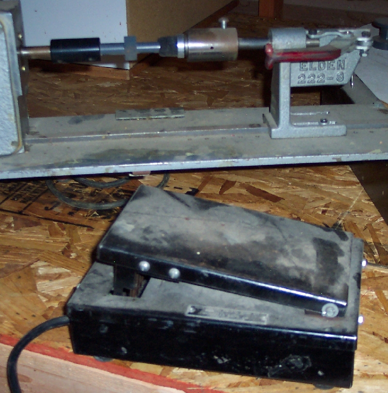

Medium machine:
This machine is older than I am, and I am old.
It came too fast so we added another wheel to reduce the speed.
Note foot speed control. There is a counter. The red lever moves a shaft on the right to capture the transformer. You might be able to see a gray part in the center. That piece fits the inside of a transformer. I have many different pieces like that. (tool) This works on transformers from about 1 inch through 5 inches.

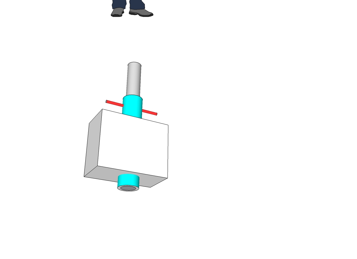

Can you show one of your transformers mounted on this machine? Thanks.
I do not have a photo of the pieces that hold the transformer. Each one is different. Many are made like the picture. I have a 1/4" shaft, gray, with a screw or pin (red) to hold the PVC in place. There is a PVC pipe with 1/4" ID that slides over the shaft. The PVC is glued to a rectangle block of PVC that is filed or milled to match the inside of the transformer. Not shown, there is usually a stop that keeps the rectangle block from going too far into the transformer.
Hope this helps!
