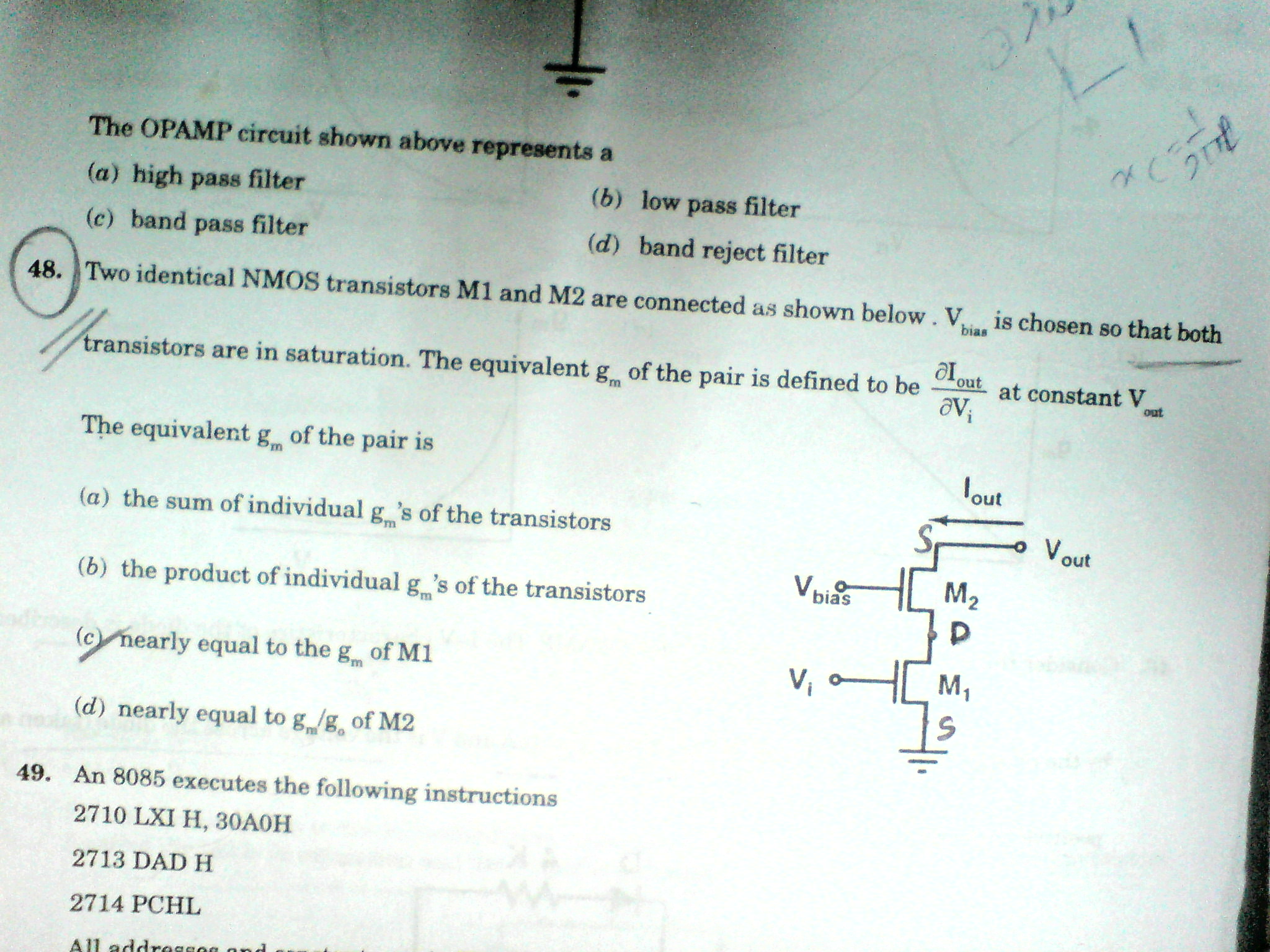

anybody plz solve this mosfet transconductance problem ....
munna007
hello friends....i can't understand about this question totally....can anybody help me regarding this....its answer is option (C).
.i have attached image for this question ,question no. 48................
thanks....:)

The circuit is a cascode amplifier. M2 has a constant voltage on its gate so it is operating as a common-gate amplifier and thus has no significant effect on Iout, which is primarily determined by M1. Thus the gain of M1 determines the gain of the circuit.
Incidentally, if the S on the top of M2 is supposed to indicate the source, that is incorrect. The top of M2 is the drain.
