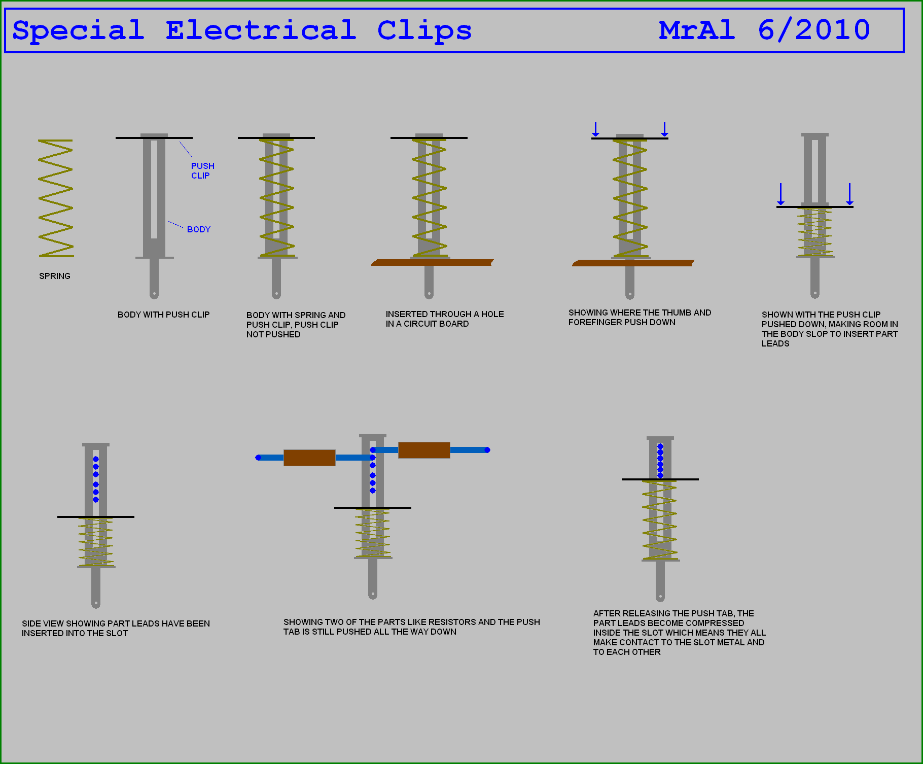

Hello there,
(Please see attached drawing for complete description, and zoom to see the writing in the pic)
These are special clips where you press down on the push tab and that opens the slot in the body where you can insert part leads such as from resistors and capacitors. After you insert several leads you release the tab and that compresses all the leads together which means they make electrical contact to each other and to the metal of the body. That means you can a bunch of them to make up a breadboard or just use them to connect other parts together for quick testing.
I purchased a bunch of these from Radio Shack way back in the 1980's but they dont seem to sell them anymore.
Anyone know where to get this now, or if they are even still being made?
Note that i am not interested in Fahnestock clips.
Thanks...

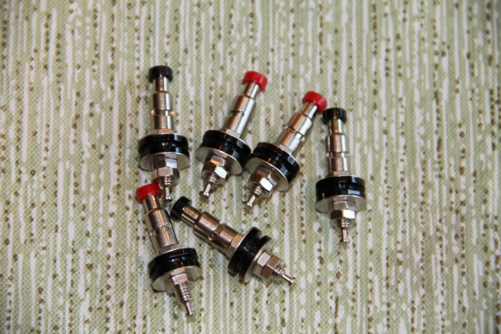

I have 6 (3 red and 3 black) that are yourss if you want them.
Ron

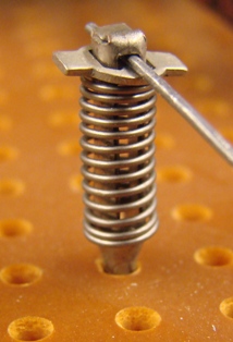

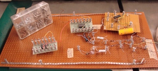

Is this the right clip? I couldn't find mine, but remembered we had some stuck away in never-to-be-used-again storage bin at work. Besides the clips, are a couple IC sockets with clips, and an 8-1/2"x17" perf' board w/ bus strips for them. All yours for the shipping.
Mine were slightly different...they had an islet at the top.
Ken

MrAL,
I have 6 of those just like the picture that Ken posted, if you will send me PM with your address I shall put them in a evelope and mail them to you at no cost.
Ned

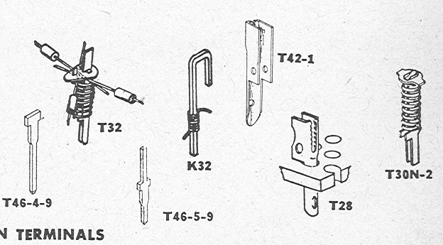

A bit of history from a 1979 Pioneer-Standard Electronics catalog. They were manufactured be Vector Electronics...as in Vectorboard. ;)

The parts pictured in Reloadron's post #10 are made by Grayhill.
https://www.electro-tech-online.com/custompdfs/2011/09/pushpoststerm.pdf
Pomona makes these similar spring loaded binding posts.
https://www.electro-tech-online.com/custompdfs/2011/09/d4995_100.pdf

The Vector T30N-2 is obsolete but some vendors still have stock.
