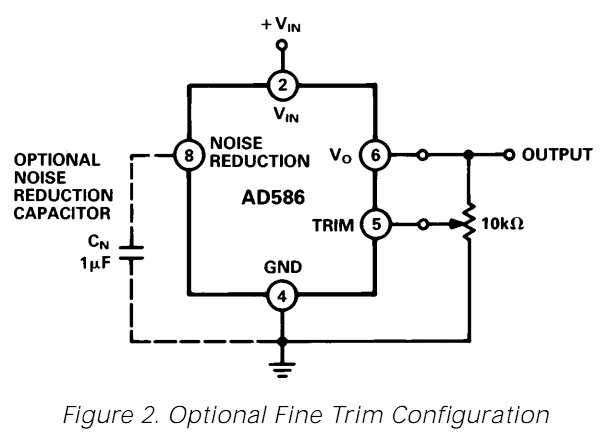

Anyone have experience using voltage reference IC AD586?
flat5
I built the simple circuit but the output is 5.46 volts. Not 5 volts.
Three meters concur.
Circuit is SO simple I can't see that I've done something wrong.
Using a bench supply at 12 volts.
Added the 1uf low noise cap but not the trim pot.
Built on a perf board and the IC was socketed as the last step.
What circuit?

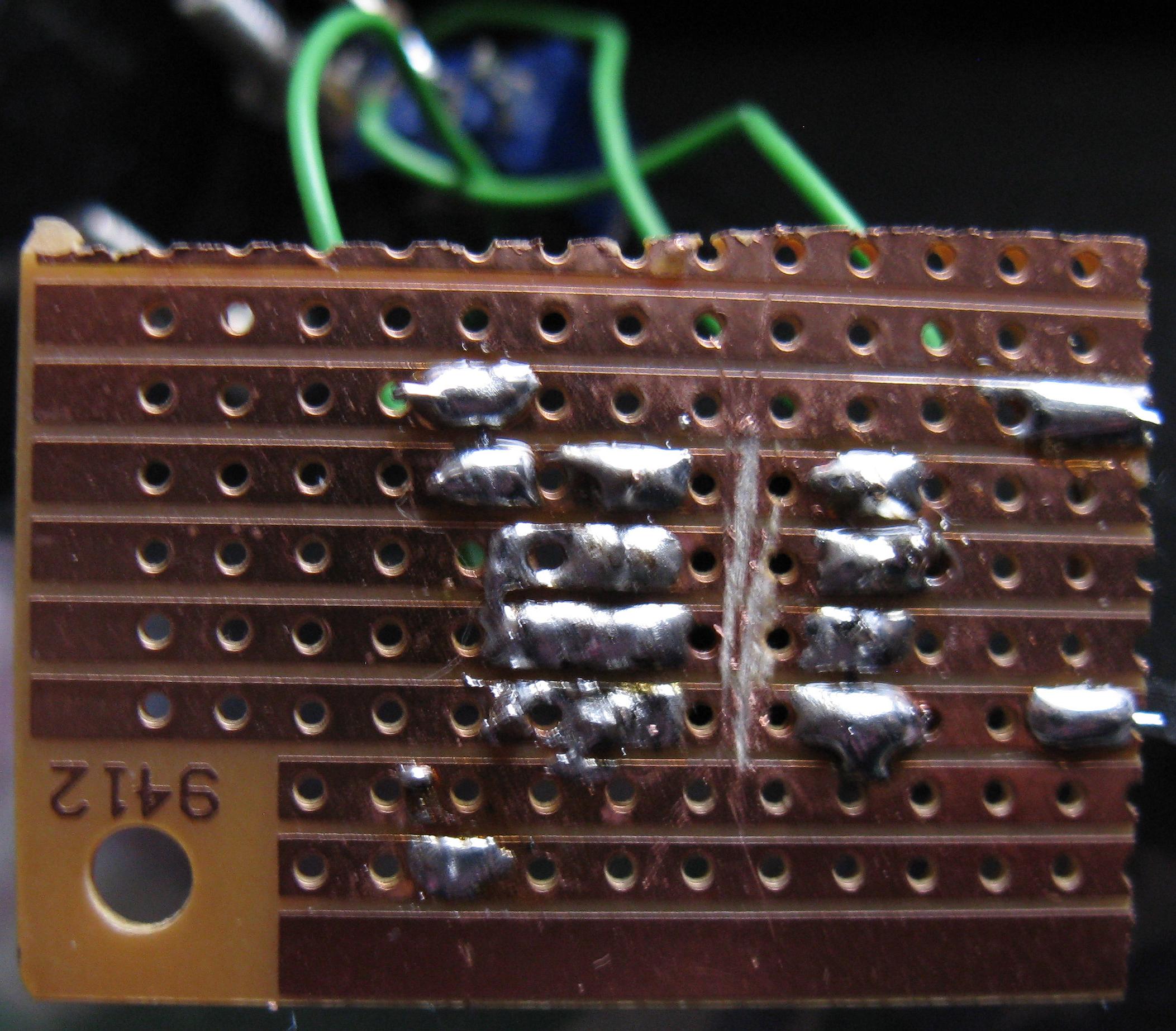

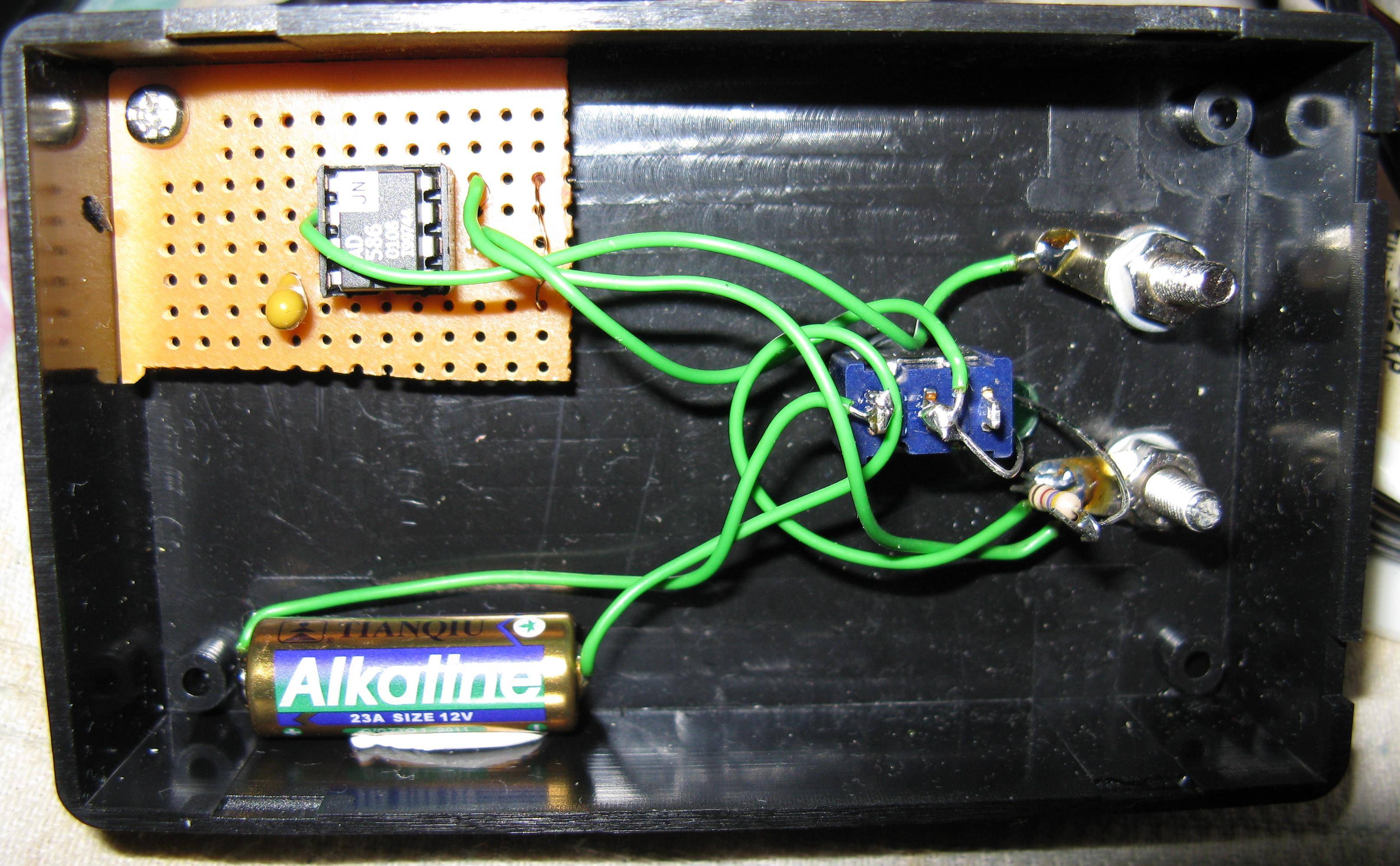

It should work.
Have you double checked the pinouts and wiring?
Can you post a picture of the wiring?
The Output, Trim and GND pins are adjacent to each other.
Could it be that there is a blob of flux or whatever, bridging the pins and affecting the output?
Otherwise, there is not much to go wrong with that circuit!
I'm m bare assed :)
I did not see the shorts until faced with the full screen pic.
I should know better! Always check with lots of light & a magnifier!
Very bad solder work - and with a new solder station!
(I was doing the work at 3am)
I just got some .3mm solder and will start using it.
I believe I've applied too much solder.
Also I think I should have cleaned the board before soldering.
The solder might have flowed better and I would not have used so much.
It's all cleaned up now (relatively speaking).
