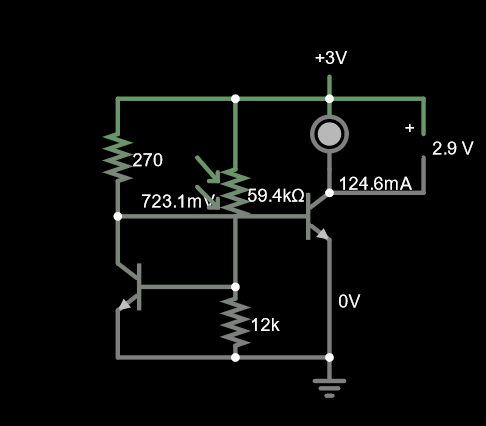

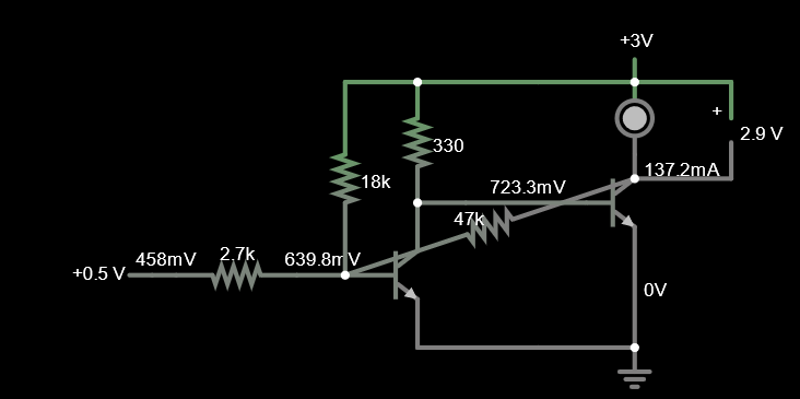

I am going to use solar panel that the landscape light comes with as my indicator if its night time or day time to turn lights on or off. I measured and determined from solar panel that at 0.5VDC or below it is dark enough so that the lights should turn on. Above solar panel 0.5VDC lights should be off.
Now my next challenge is to build a circuit that meets below all requirements.
Requirement 1. I want a circuit that constant 3 vdc if I put my adapter at 12VDC or 6VDC then I also want the circuit to output constant 3VDC. I would do 12VDC or 6VDC so I don't have to worry about voltage drop in field. I don't want to do resistor divider for the constant voltage because if future the adapter would not only power landscape light but also other items that are not 3VDC. I just don't know voltages right now.
Requirement 2. Turning lights off 0.5VDC or below and turning lights on 0.5VDC and above. Does anyone know how of good circuit I can build from transistor, resistor, diodes etc which can switch the led landscape light on at 0.5VDC or below and light of at 0.5VDC above?
If you do then can you please post it.
You will run into thermal losses and excessive temperature rise in your plan. I suggest you fix that by using a much lower voltage less than 5V with a current limiter and not CV.
https://www.amazon.ca/LIFKOME-Ediso...pcontext&ref_=fplfs&psc=1&smid=A2466VW74JWMT4
With a 3V LED 120 mA , at 25 'C you can use your adjustable 3V supply with an NPN switch for the current limit then use the PV with a resistor to turn off the base.
Your values will vary. https://tinyurl.com/2b7q4zdl
I dont have adjustable 3V supply.
My 3V supply is constant and it is power source for the led lights.
I have second supply that varies from 0V to 1.5v. I want light to turn on when that adjustable supply is equal to or below 0.5V and turn off when above 0.5.
Well you can choose taps 3 , 4.5 and add series R to limit power dissipation. or just use 3V and no adjustment.
Then just use a transistor switch with suitable gain, threshold and current limit. or a comparator active low drive.
I dont follow.
My adjustable voltage is from 0V to 1.5vdc which is coming from solar lanel.
My constant voltage is 3bdc which is coming from plug.
I want to turn lights off above 0.5vdc and on below 0.5vdc.
Can you show me circuit?

use a DC-DC buck converter to step down your 6V or 12V adapter to a stable 3V for the LED. For controlling the light based on the solar panel voltage, create a voltage comparator circuit with a threshold of 0.5V. When the solar panel voltage drops below 0.5V, the comparator triggers a transistor to turn the lights on. When the voltage exceeds 0.5V, the lights turn off.
