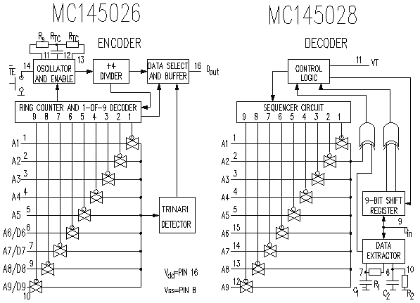

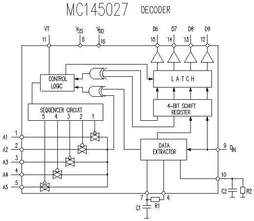

Anyone know about IC MC145026(Encoder) and Mc145027(Decoder)
Yes. For complete datasheet(pdf) PM me with mail address.
Maybe this also enough:
