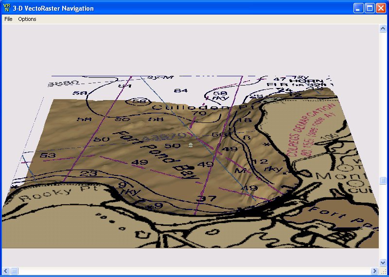

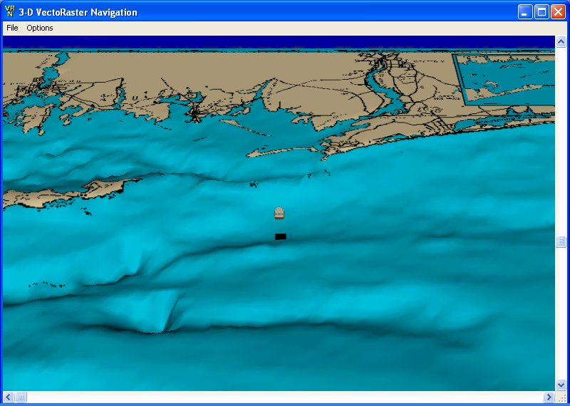

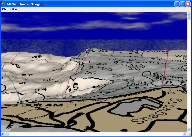

I modified this Direct X sample source code
to make a live, real time, 3-D navigation display of the ocean floor.
It was a lot of work but it turned out the way I wanted. I made my own flat mesh, then applied depth soundings to it from a 4 megabyte data file in memory. That made the mesh into a height field. Then I applied the corresponding section of nautical chart to the mesh. That Dolphin sample was in the Direct X 8 Software Development Kit for C++ and VB.

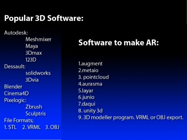

thats the page i was checking out, and revisited pcl, already have maya and 123d as well as inventor and blender, also i found Rtab map which looks like what i want,
maybe its just me thou but all these progies seems more intent on creating object blobs and shaping them , as oppose i am thinking i want to create point speckles from camera, an then maybe form as object afterward,

The Direct X mesh is triangles with all X,Y,Z points saved in text format with a filename.X extension. All points are addressable and alterable in memory. That is what I did to make it a live 3-D view of the ocean floor under your boat. The map is a 256 color bitmap that I could get sections of by their x,y coordinates.
I used their “Dolphin” sample code as a template & starting place for loading files, moving the mesh and applying the map (skin) and the 3-D view window.
What, exactly will the finished product be? A picture? Animation like a video game? Physical 3-D printout?

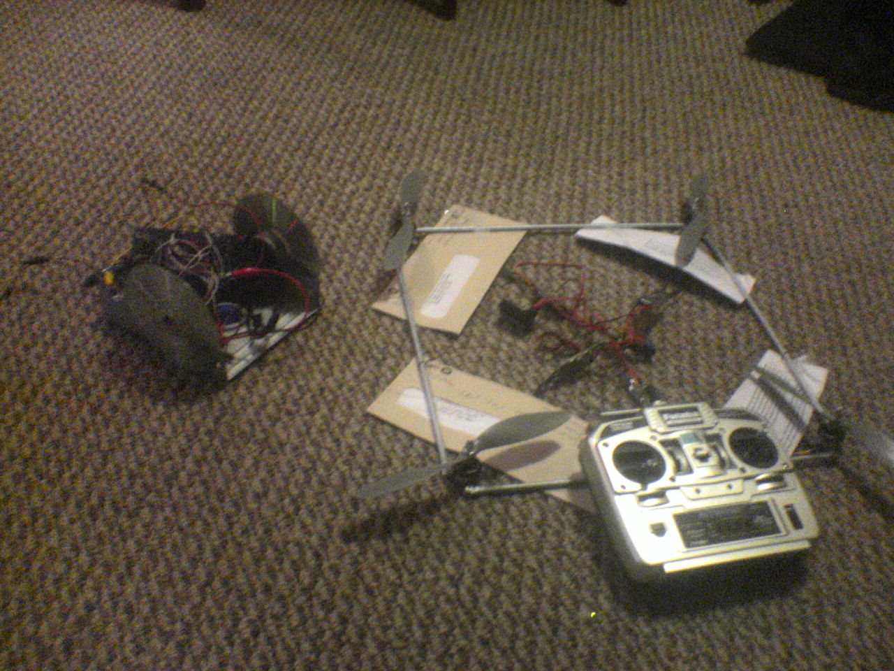

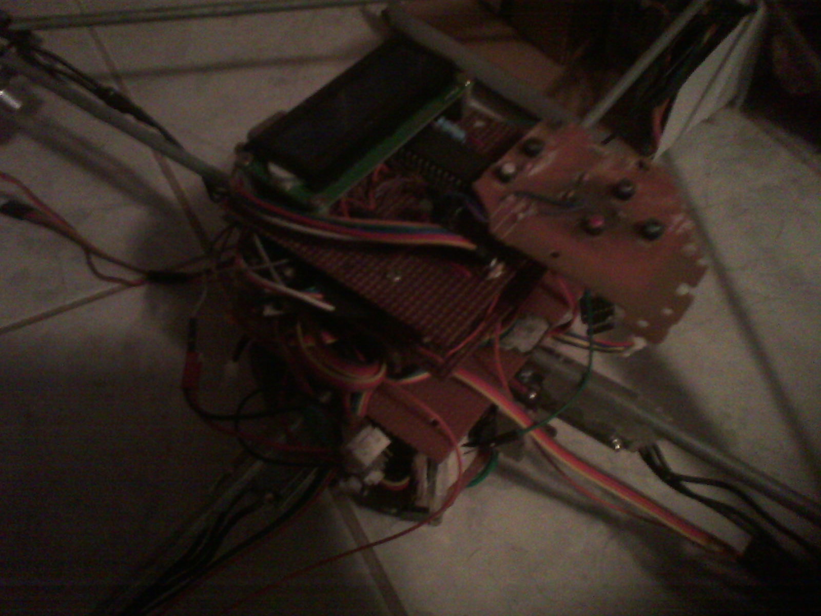

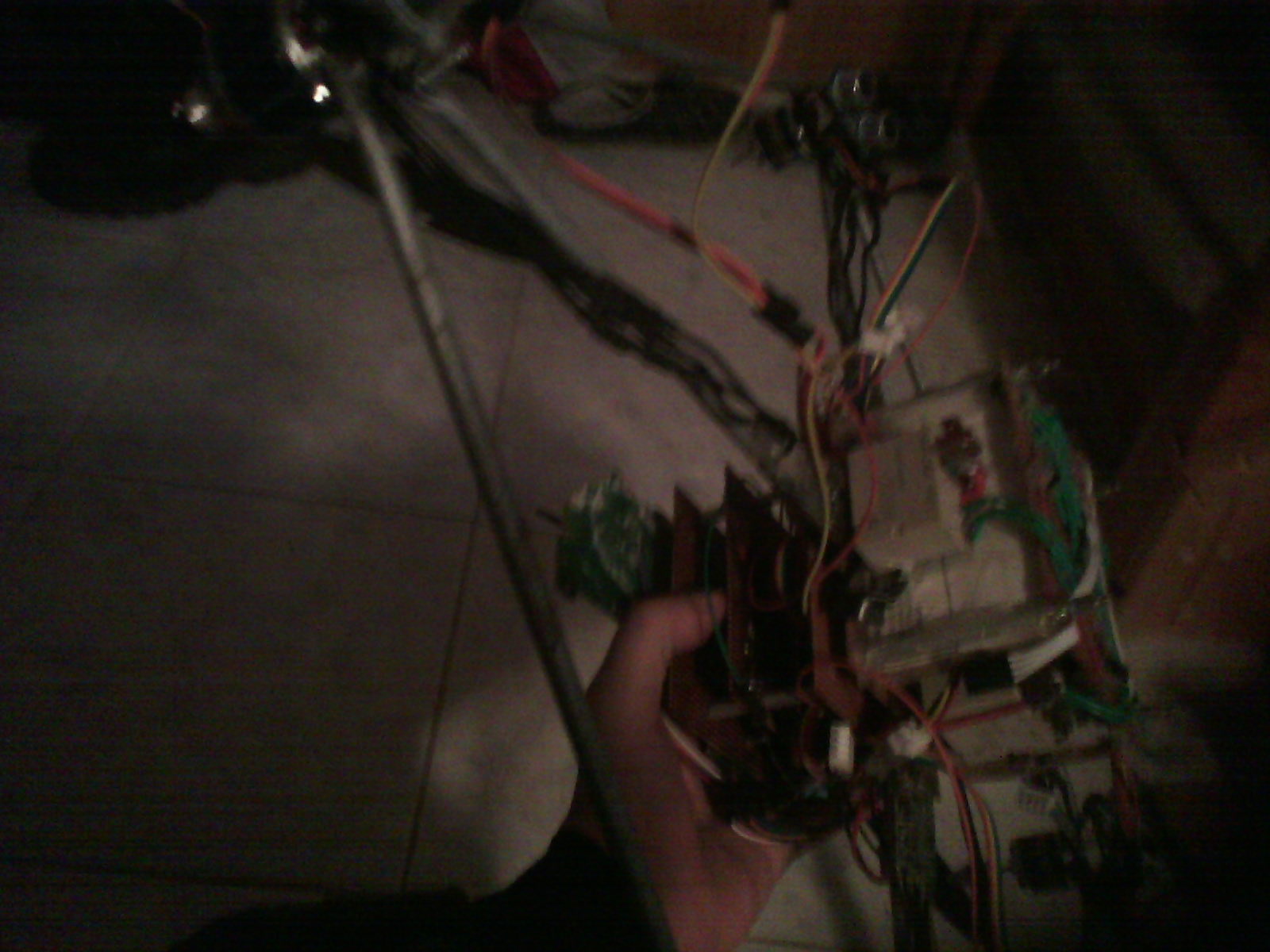

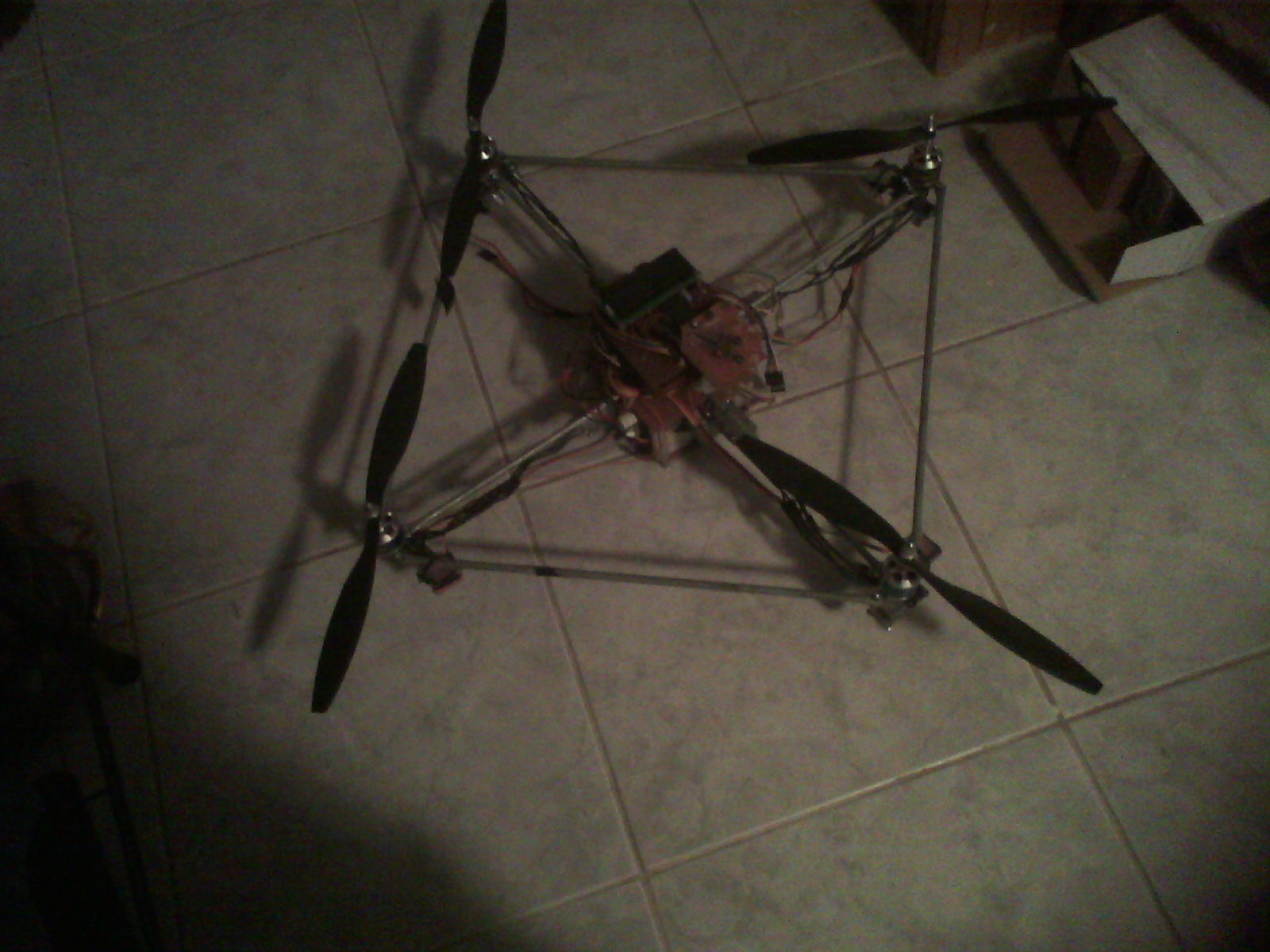

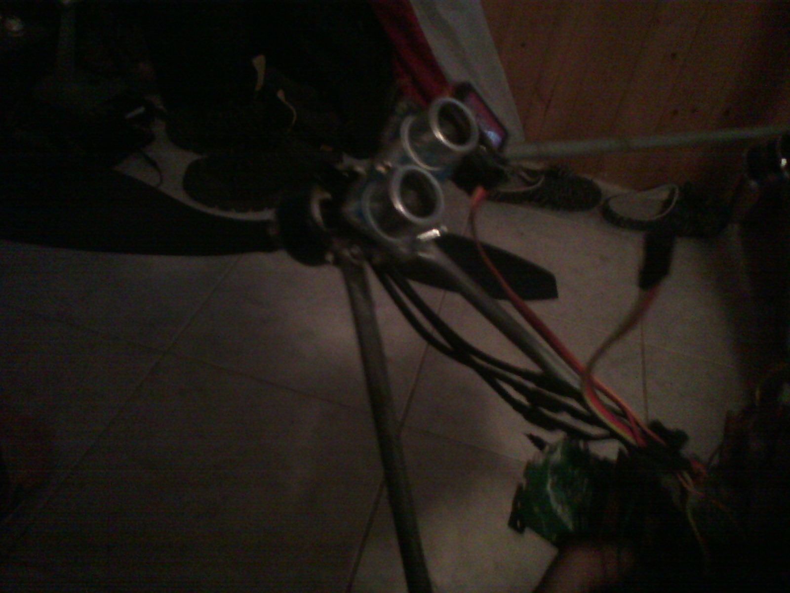

well some years ago when i first learned about microcontrollers i did a quad rotor, trashy design, it was kite shape frame that used automotive break line(nice,light malleable but sturdy) sandwiched between pcb's and standoffs,. hot glue for impact buffers, and cardboard walls to hide guts.
i got as far as running microcontroller off a futaba remote, it was able to take off and land, hard to balance and control thou, never made it off "leash" tether, ESCs had relay cutoffs, linked to ir receiver (coded so i could shoot it down with tv remote(independent hardware), hardware was PIC2550(hdw ctrl) also setup with ultrasound sensor under each BLDC with servo, buttons & 232 input(for bluetooth firefly), futaba receiver, n som flashies , plus 4620 addition microcontroller dedicated to navigation & gps, , never got to coding though plan at the time was a*
with inventor & eagle i can now print a way better design , and since im doing that i want to modify body to better design , more flashies/servos and devices, plus i want to switch to gsm comm, AND have you guys seen the new pocket pc's, perfect cos now i can code on pc(replace 4620) , with lots of process power, usb to PIC(hdw ctrl), bluetooth for comm and android plugs, plus better hdw pcb, factory printed , ie not my slopy wire wrap, and POCKET PROJECTORS!!?

DSC00804.JPG IMG_20130427_140741.jpg IMG_20130427_140803.jpg IMG_20130427_140822.jpg IMG_20130427_140834.jpg
