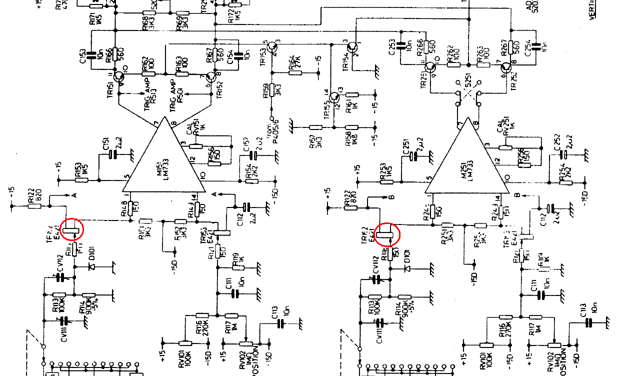

Nigel said that its usually the FET that has been blown by someone measuring too large a voltage, and indeed the service manual shows what I believe is a fet in each channel, but the schematic is strange to me, some parts of it seem to comprise of many small circles that are obviously meant to tell me something, but don't, have a look.
If you see anything you think may be the cause let me know, I didn't want to go exploring in the scope and perhaps change a working component and introduce more possible problems.

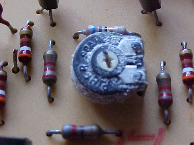

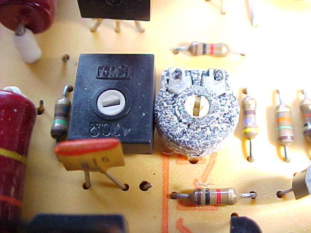

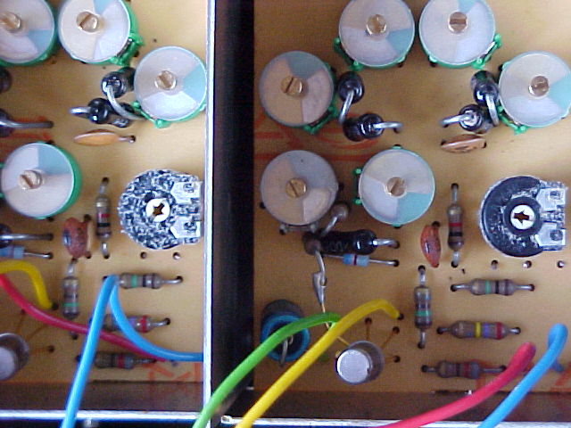

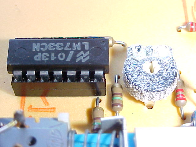

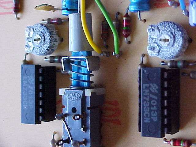

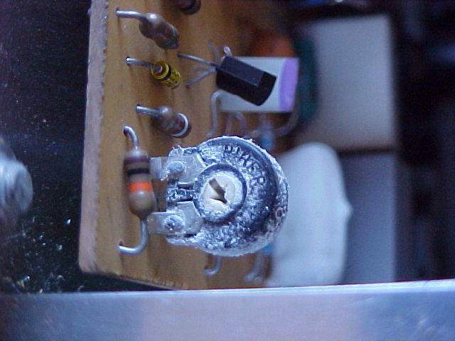

PS I also noticed what looks like white mould on ALL the presets in the scope, but isn't present on anything else. Is this normal for the age of it or some other reason?
I will get the wife to take some good close-ups inside the scope and post them here, see if anyone has seen the white stuff before.

I think that white junk is oxidation. Maybe you need to replace the pots. Of course your calibration would go out the window. Maybe a good cleaner spray to remove the crud.
So, cool, you met Nigel...
I have a few pots of that style, they have sat in the drawer for 25? years, and guess what - they have a white film on them!
Not quite as spectacular a growth as those in the scope, but the same sort of thing.
At a quick guess, I think the pots will be OK, if the white stuff worries you, clean it off with a soft brush.
The "circles" you refer to are trying to represent the poles on the switches, the vertical sensitivity and the timebase.
I also think I see a couple of errors in the circuit as drawn, maybe a couple of lines missing between some of the groups of circles on the y sensitivity switches.
The little boxes with text such as ÷5 and ÷100 contain the circuits shown below in the chain dotted boxes.

From the diagram I would suspect TR152, the input FET.
The fault was that the A beam was off the screen, and you couldn't get any sync even if you tried both inputs on the same signal.
As it's a dual beam scope, you might try swapping the FET over with the working channel, take static precautions though as it's an FET. See if the fault swaps beams.

Measure the voltage at the junctions of R148/150 and R151/3K3
and also R149/150 and R152/3K3, vertical position centered,
vertical sensitivity at minimum.
Next measure the voltage at the junction of R149/150 and
R152/3K3, Vertical position fully clockwise.
Again measure at the same junction with the vertical position
fully counter clockwise.

Just openened the scope and looked for the TR152 as Nigel suggested. It is a CA3046 General purpose NPN 5 transistor array, B channel also has one TR252.
I swapped them round and still had no trace from A.
They don't seem to be FETs from the datasheet so I'm wondering if there is something else in another location I should check?

The transistor I was refering to was an FET E421 (if I remember correctly), the diagram was a bit faint, but it looked like it said TR152?.
If neither traces work now, then swap whatever you did back again.
