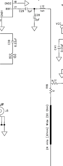

Here's all the reference designs I have. The tihng they all have in common is they all use series inudctor -> shunt cap -> series cap. I'm guessing its a low pass filter match, but the values are different in every one (probably due to different source impedances used). I may have another rep from RFMD looking into it, although I have made it clear I'm just doing 'research' and not planning on ordering 5k parts, so they probably have more pressing issues.
Although I have used 0402 on several contracts, its really the limit, I can solder 0603's all day but 0402, as you suggested, requires a microscope, so its on the cusp of my 'skills'. Using the utility TXline, it seems if I use a coplanar waveguide (as opposed to just a microstrip) to route the RF, the width can be 32mils. As I'm flooding the top layer with ground plane anyway (as well as the entire underside) seems like a good idea to use CPW, it also makes the RF traces roughly the same width as the pads for 0603. As for non-RF parts, I can easily put a track under 0805, parts, done it a few times on my own boards with 0603 - but never with 0402. Makes layout a hell of a lot easier, allow almost all my via's to be purely ground.
Anyways, I've drawn a blank with all these. If the datasheet is right about the input impedance being 2.2-j0 (or 2.6-j2.6 later on in the document), then although I can design a lovely matching network for this, I cannot reconcile these schematics. My match uses a shunt inductor, and is a fairly wide 'bandpass' - and conveniently uses standard values. These reference ones are totally different on a smith chart.
Regards, and thanks for sticking with me on this :)
Working backwards from available info I get these values for the input Z of the ic:
for the first image, starting from 50 ohm tx line 9.2-j33 ohms
for the second image, using BFG425W 7.4-j39 ohms
for the third image using RF24xx 3.2-j40
There is a lot of potential error in these estimates because they omit all the pcb contribution to matching impedances, but it is interesting that they are roughly in the same ballpark. Unfortunately, that ballpark doesn't seem to be 2.6-j2.6 ohms. Anyway, this dilemma is one reason why an RF engineer often resorts to using instruments to get the job done.

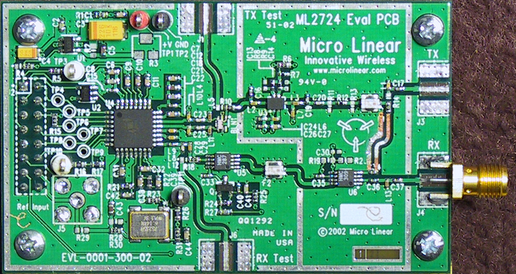

Update!
Well, it has been a couple of months, but I haven't forgotten about this project (or Radiorons help!).
I ordered a batch of parts last month, but still need a few more passives... as I got used to using smith charts and other software to work out optimum values for caps and inductors, as well as managing to get hold off some half decent RF amps.
Here's the layout so far. Not complete, still requires the logic for the TX/RX switch, an oscillator, and a regulator. But I'm satisfied with the RF, as much as I can be. I realise without studying the datasheet for the transceiver or any of the parts, one can't give much in the way of specific advice on the PCB - but I would appreciate some constructive crticism on it. Its my first microwave/RF PCB, and I've probably been overly cautious, but its still within the limit of my PCB making/soldering.
Cheers!
Blueteeth
It looks pretty good, so my list of quibbles is not long.
At these frequencies I would avoid thermal reliefs on ground pads.
It appears that your SMA connector leads do not land on your SMA ground pads.
I would include some additional ground via stitching along the tx lines leading to the connectors.
You need to stitch the edge of the board with ground vias. The edges are where current tends to collect and they have to be taken to a common ground.
I usually back my ground away from the tx line a bit more than you do, but if you are calculating your line width by accounting for the contribution of microstrip and coplanar impedance, then it is fine.
I'm not sure about this point, but it seems as though your center lead pad on the SMA connectors is wider than it needs to be. Why are you using that particular width?
Not an "error" but:
when I'm making a prototype, I often try to predict where I may have to add shunt components for matching or whatever and leave the ground plane alongside the signal trace without a solder resist covering so that i don't need to scratch it off to play with adding parts.
