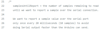

Hello Community! I'm facing some problems to understand the code that I want to work with on my project. I found it hard to understand some comments on the code, that I found on Github. In brief, I'm looking forward to doing a simulation of a signal related to my heartbeat sensor. You'll find down below the schematic of the circuit, the code, and the picture of the comment that I didn't understand. Thanks for your help!!

It's hard to tell without looking at the library as pulseSensor.outputSample() is contained within the library.
However, in 20mS at 115,200 (see Serial.begin) baud you can send 115,200/50 bits, so over 2,000 (~200 bytes) each time.
So, I'm also confused by the comment.
Edit, maybe, when they wrote that comment, they were running at the default 9600 baud.
