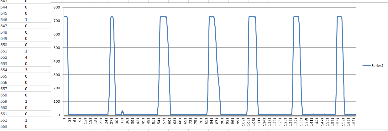

I have a problem in coding this graph in arduino. As i display the serial monitor, it logs analog values up to 730units. the value is indicated in the attached graph..
My objective is to count how many pulses(high) there have in a defined time.
Can I ask for a help. Thanks in advance..

You just want to count them without outputting them to the serial monitor?
Yes Sir, The value that'll be displayed on the monitor should be the amount of pulses it have in a defined time, for example 60seconds..
The pulses seem to be coming from an AD input (analogRead())?
This shows how to time a pulse that comes from a digital input. Modifying it so the pulse comes from the AD is simple. This shows how to use the millis() function to time things. You can use it to count things just as easily.

Im having a problem in what point to set before the variable will increment because the analog reading is a series of 0's and exponentially goes up to series of around 730 and drop down to series on 0's again without a definite time when and how long the pulse is. The time each pulse last is different to each other..

You can't count a analog pin your setting it with this A = analogRead(A0) back to ADC that's going to give you a value of 1 to 1024.
What your seeing is the voltage go from 0 to around 3.5 volts to count if it goes up to 3.5 you need to do some thing like this.
If A= >720
counter = counter +1
