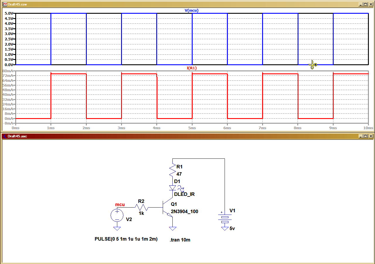

right, so increasing the current to the IR led is not an option?
when the specs for an LED say 100mA max, and if my signal is modulated, how to I measure if I'm at the maximum safe current. (I do have an oscilloscope).
If the LED is being driven directly from a MCU pin, ie: no series resistor then thats a max already.
You could use an external drive transistor for the IR emitter, drive the base from the mcu, do not forget to allow for the signal inversion.
E
E
thanks for mentioning signal inversion - I would have been stuck for a long time.
could that be flipped in software?
This circuit will drive the LED ON, when the MCU pin High.
You not did say say if the MCU pin was sinking or sourcing the original LED current.? This circuit assumes that the MCU was sourcing the original LED current
E
Hi eric,
Thanks for the reply - the MCU is sourcing (I believe as the other side of the IR LED is connect to ground).
