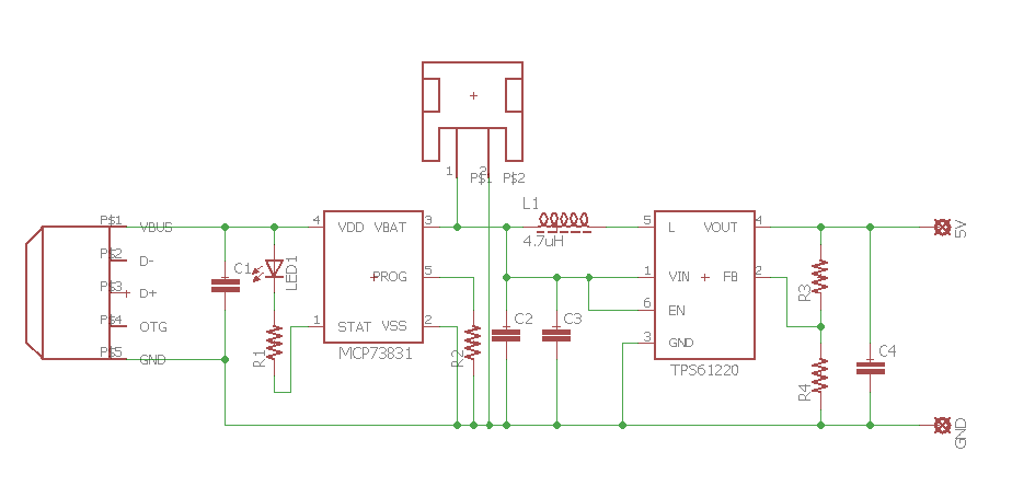

Thanks all for the info. The circuit in question is a micro USB to a Lipo charger followed by a stepup regulator to 5V. Here's the schematic,
The battery connects to the central connector. Looking through the datasheets suggests that ceramic caps are to be preferred. Can anyone see any problems with this circuit?

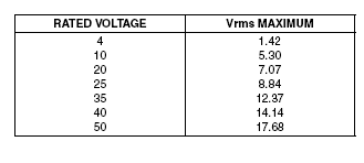

The thrust of that note, which is dated April, 2006, is about calculating power dissipation by tantalum capacitors and the need to stay within manufacturer's specifications. It does provide a table for maximum RMS voltage compared to maximum DC voltage:
But that is not about imaginary ratings, but rather power dissipation. In fact, it does not use the term "derating," as according to the note, that is not what the limitation is; although, some people like to use that term for simplicity of communication.

Please state our goal here.
How much current will you pull from the USB source? (500mA)
How much current do you want to charge the LIPO with? (500mA)
How much current for the load? What are you powering? (100mA)
What size of LIPO?
What voltage will you put on the LIPO? (3.7v)
How long will the lipo support the load?
Will you be "charging" and powering the load at the same time?
The LIPO is a 1000mAh single cell and will be charged at 1/2C (500mA). See here.
The chip above stops charging at 4.2
The load is a pic driving one or more vibrators - normally 30mA - occasionally (once per hour max) around 300mA for 0.5 Sec.
It may be accidentally left on whilst charging but I don't think this is a problem.
The off state will be the chip in sleep mode drawing a few 10s of nA.
I'm hoping the LIPO will last at least 1 day with constant use - 12 hours would suffice.
If a problem with battery life I can switch to the 2Ah one stocked by Sparkfun.
I don't think you can get 300mA out of the 61220. Probably more like 150 to 200mA. See page 6.
Note both the battery charging current and the 61220 input current come from the input regulator.
The first IC is a linear regulator. 500mA in 500mA out.
The last IC is PWM. Power in = power out - some loss. So input current and output current have a non 1:1 relationship.
The last IC is a boost power supply. If the battery was at 2.5V and the output is at 5V and 100mA; then it will bake 25omA of input current.
Output 5V 0.1A 0.5watts
Input 2.5V 0.2A 0.5watts + 10 to 15% more current for efficiency.
Sorry Ron, for some reason I had it in my head I had 500mA available. I can sort that so it's never more than 100mA and then only for less than 1 second.
When (accidentally) powered whilst charging it will never take more than 30mA. Do you (or anyone else) have experience with LIPOs and capacity. In theory I have 3.7Wh and I'm using ~150mW - is it reasonable to expect at least 12 hours (1.8Wh) from this setup?
The datasheet for most boost PWM might say "500mA switch" or transistor but that is the peak and only for a small percent of time. It is easy to mis-read the data sheet.
You understand now. I think you have moved events in time so only one buzzer is on at one time. I think 100mA peak and 30mA all the time is good.
3.7Wh is like 370mWh for 10 hours. or 185mWh for 20 hours.
Look for the minimum discharge voltage. (3.0V??) It is the voltage where you should stop pulling power from the battery. Your current is low so there is no problem there. Watch for max charge voltage and min discharge voltage.
