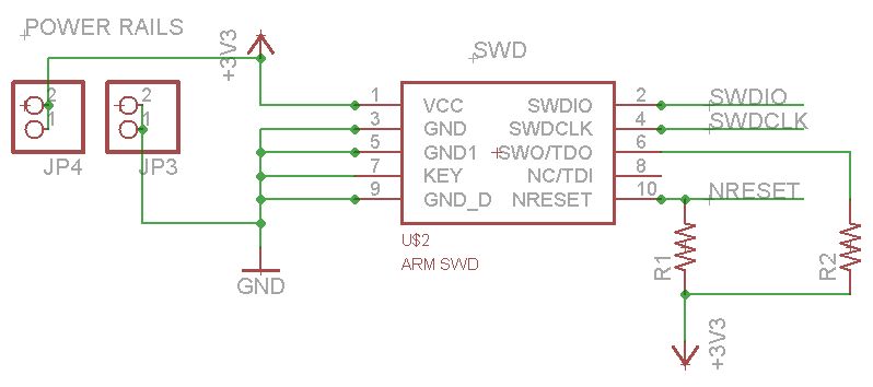

Ok im looking at this page:
https://www.keil.com/coresight/connectors.asp
and even on the ARM site has same info...
I though SWD was basically a 2 wire thing ? SWO and SWCLK and of course RESET and POWER PINS... so whats with
SDWIO
SWDCLK
SWO
? i know to use SWDCLK but which one of the other 2 do i use ?
SWO or SDWIO ? i bet its the SDWIO but not sure and dont want to make a PCB for nothing :D
You think based on that side and its pinout and this pinout i made, should i be ok ? its a smt part so dont really want to solder and desolder...

Ground 3, 5, 7, and 9. Connect 6 (SWO) to 3.3V with resistor (pull up). Leave 8 floating. Pullup reset. I've been using a reset supervisor as well, but not really needed.

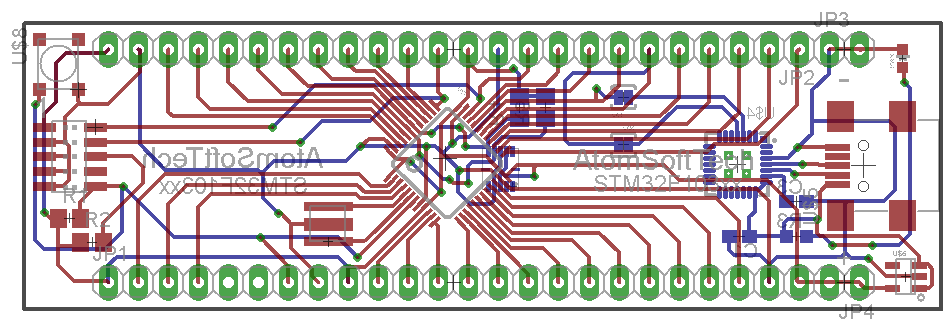

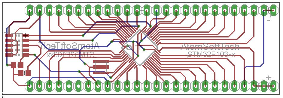

Ok here is what i have so far:
swd-jpg.54410
This is my layout so far.. still working on it... might try to make it smaller and add some stuff :D
pcbr1-jpg.54411

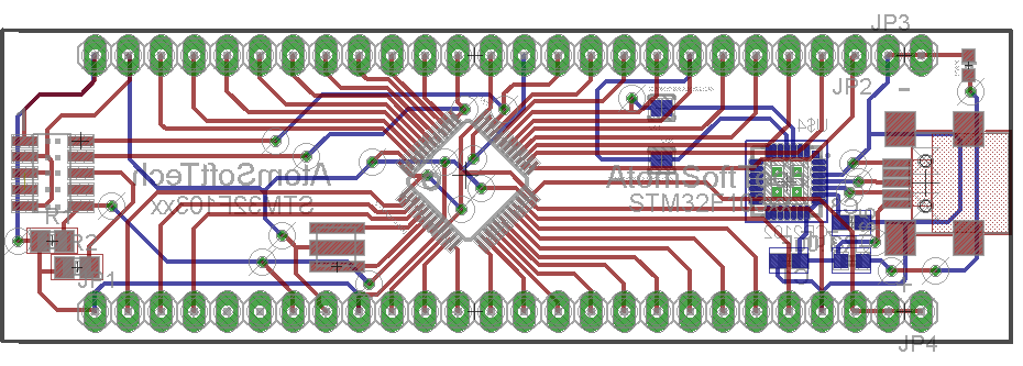

ok so far i think im done. I have to send this PCB to get made now :) going to wait until monday tho. just in case i read something and want to add or remove something :D
I added a UART to USB (CP2102) IC and will use solder jumpers to connect the RX,TX lines .. just in case i dont use them i can desolder it...

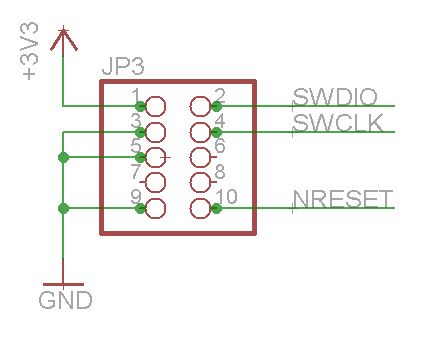

:) i get bored as you can tell... i added a MMA7660FC which is a 3-Axis Orientation/Motion Detection Sensor or as we all know it "XYZ-AXIS ACCELEROMETER"
Also a reset button. I also fixed the SWD... i forgot to connect the ground and stuff :D
Also i uploaded the schematic and board file in Eagle Format for those who want it...

Looks so pretty :D whats that behind it... uses I2C i think...
Ah thanks. i knew i forgot the caps
Edit: Ok added 5 caps. 4 for power pins on MCU and 1 for MMA7660 IC... The CP2102 already has its own caps...
