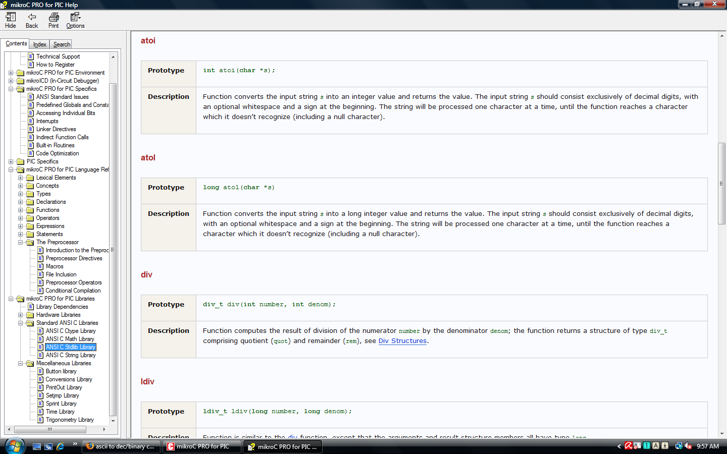

can any one tell how to convert ascii to binary or dec using assembly /C/ MIKROC
einton always check the help out
The C conversion functions are really wasteful for single bytes.
// To convert single ascii bytes (if ascii is '0' to '9') you can do this;
dec_digit = (ascii_digit - '0');
// in reverse, to convert a number 0-9 to an ascii character number;
ascii_digit = (dec_digit + '0');
