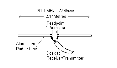

end points are never referred to when talking about impedance of an antenna, you are getting your terminology mixed up. As I said in my previous post the FEEDPOINT is the only place you need to be worried about impedance. And as I said, this is already relatively well known.
a 1/2 wave dipole length is worked out by the following formula
wavelength (metres) = 300 / Freq (MHz) so for your 70MHz .... wavelength = 300 / 70 = 4.28 metres
for a 1/2 wave dipole = 4.28 / 2 = 2.14 metres
Have a look at this basic diagram.....
dipole-feed-gif.58929
The feedpoint of this dipole will be ~ 75 Ohms give or take a couple of Ohms.
the two aluminium elements would be mounted on a plastic block. These blocks are commonly available from places that make/sell TV antennas.
Dave
Now for receive only you will get away with connecting the coax cable directly to the elements as shown. Braid of the cable to one element and the core of the coax to the other element.
Strickly speaking its not a perfect way to do it. Reason is, coax cable is an unbalanced transmission line and a dipole is a balanced system.
For receive only and low power transmit it is acceptable and will work ok. For higher power transmit say 10W and up, I would use a BALUN.
a BALUN is a BALanced to UNbalanced transformer to match feedline to feedpoint.
If a balun isnt used RF currents are likely to flow down the braid of the coax and be radiated ...This can cause all sorts of problems.
If you really insist on wanting to measure the feedpoint impedance, then you will have to spenmd the money and buy an antenna analyser of some description and ensure it covers the frequency of interest to you.
