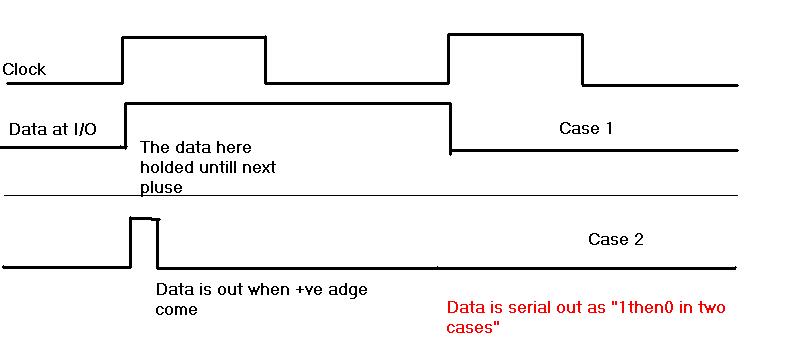

but i must make it parallel port and i see more that one of programmer device work in this port, and i cannot use any program that because i will be a part of my program in will make it in Visual basic,
but look it the picture " if the data is 1 the o will out " in the case1 we will find that the data is holded untill the +ve edge come but in the next it send the data as pluse.....
is the data is out from the card as case1 or case 2?

As already mentioned, you need to find out what is inside the smart card, and what it's interfacing requirements are - different types are likely to be completely different. As also mentioned, PIC processors are used on quite a few smart cards, you can download the programming specifications for these from MicroChip.
Assuming your particular smart card uses a PIC processor, all you are really doing is building a PIC programmer.
If you need to be able to program different types of cards, again you need to find out their exact requirements, and write your program accordingly.
If you need to use the parrallel port you are probably better off using a memory card instead of a microcontroller card. Memory cards use a standard I2C interface. There should be tons of info on using the parrallel port to emulate I2C.
