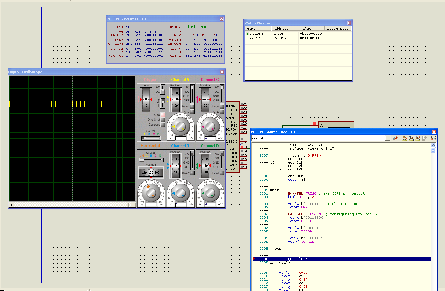

Hey,
I'm trying to set up the CCP1CON module of the PIC16f870 microcontroller in PWM mode. I wrote this simple code that's supposed to send a 100% duty cycle on the CCP1CON(RC2) pin. I have attached a dc motor interfaced with a L293D driver to test the duty cycle's value. I have calculated the values for the registers using this PWM calculator:
https://www.micro-examples.com/public/microex-navig/doc/097-pwm-calculator.html

My CCP1CON(RC2) pin won't initialise. It stays in 0 logic no matter what duty cycle I send. What am I missing? I calculated a pwm frequency of 1.5khz and a duty cycle of 100%

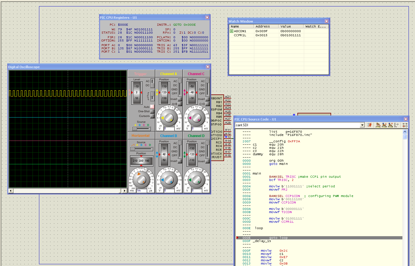

I'm starting to think there is an issue with your sim..
The code and schematic work fine for me...
Two screenshots.... one with CCPR1L at 11001111
And CCPR1L at 0100111..
The scope said it all...

I have wrote this code for the PIC18F2550(basically same thing re-written for this MCU) which has an internal oscillator. Now everything works fine. So I'm guessing my problems arised because of the way ISIS or my program was intepreting the external oscillator which I was feeding the PIC16F. I'm aslo guessing the other programs which did not work for me but worked for you would work now as well.

Thank you Ian Rogers for answering all my questions like always :D
My Sim had some issues with how the config word was setup and the start vector. I use MPASMWIN compiler.
Anyway, with a few minor setup alterations everything seems fine.:)
