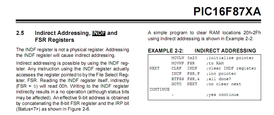

Could someone help me write a code to clear the Ram locations from 40H to 4FH using indirect addressing mode in assembly language...I am not familiar with assembly that much.
Thanks.
Thanks.
Its all in the datasheet.:)
