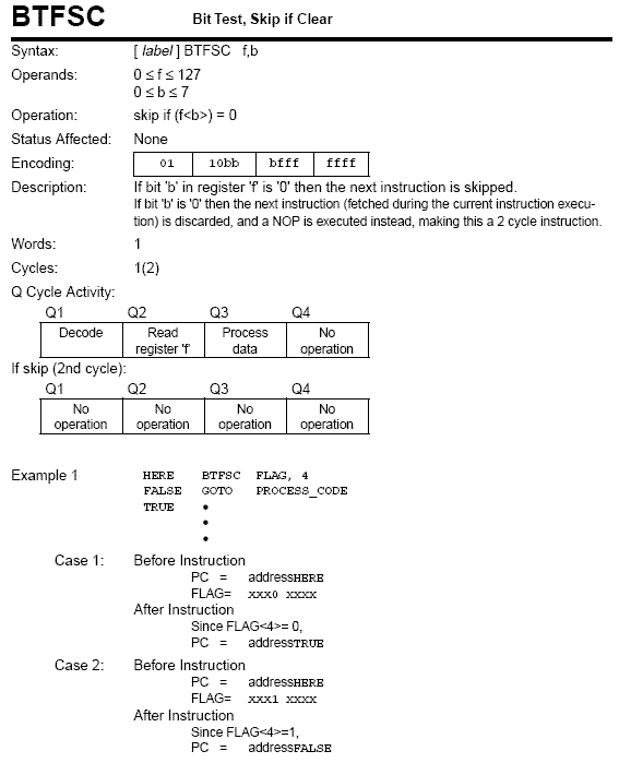

I have been reading some assembly tutorials and I am starting to understand some of the basic functions. One thing that I havent seen is IF...THEN type coding. Examples:

upand_at_them said:
btfsc PORTB, 1
bsf PORTB, 4
-Mike
I am sorry Mike, I have not read on the btfsc command yet. :oops: Could you explain how this works?
You should have the datasheet for the PIC you intend to use. Every PIC datasheet contains a command set summary.
-Mike

the label ADX uses the btfsc command..
it is testing for a flag bit , and looping till the flag is cleared..

Okay I have been studying the datasheets. Let me see if I have this right.
I have a 16F628A with a push button switch on an input pin. When pushed the pin gets pulled high. When pulled high the PIC tells another pin of choice to go high.
loop
BTFSC PORTB, 7
GOTO PIN_IS_HIGH
GOTO LOOP
PIN_IS_HIGH
BSF PORTA, 4
GOTO LOOP
END
Am I close?
Yep, that'll work, Gator.
One note, though, is that most inputs are tied high and pulled low. Pulling an input high means that it is untied and floating when the button isn't pushed. So, tie the input pin high with a resistor and use the switch to pull it low. And change your code accordingly.
loop
BTFSC PORTB, 7
GOTO PIN_IS_HIGH
GOTO LOOP
PIN_IS_HIGH
BSF PORTA, 4
GOTO LOOP
END
Am I close?
Don't forget to Initialze the PIC at the beginning. (eg set some PINs to output...)
Mike
Thanks Mike. That is good to know. I was just using that as an example for myself. For now most of what I will be doing will be with outputs.
I'm not totally sure if I pulled the pin in the PIN_IS_HIGH sub right. If I wanted to pull RB1 high, what would I use?
"BSF PORTA, 4" sets bit 4 of PORTA. Just make sure you turn off analog functions if you're using PORTA as digital I/O.
To pull a pin high with hardware you just need a pullup resistor. 10K is a good value. Then your switch is tied from the pin to GND when it closes.
