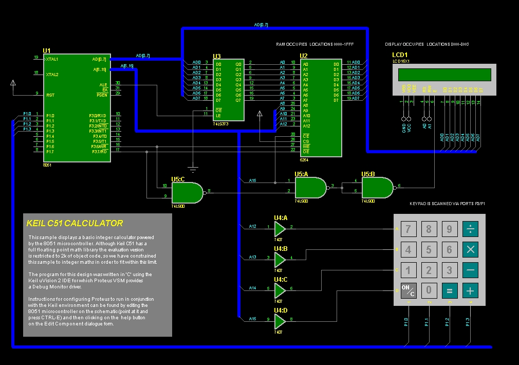

Like this?
i think its help for u.

1. i have seen the sample in protues.........
i need to know what are other IC's in the circuit.....besides 89c51.....can anybody explain??
i need code too..in c....
the schemetic is given by someone in this post........plz hurry i need help..
