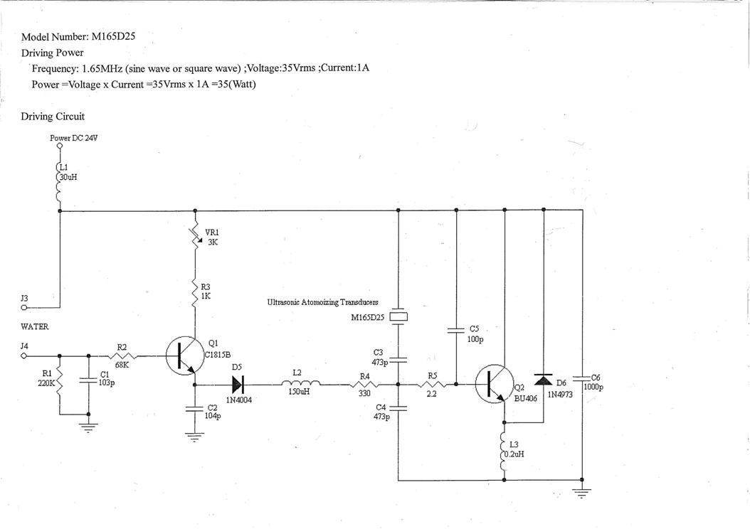

Im building a driver (see attached) for a water atomiser whose resonant frequency is 1.67MHz (standard for this part afaik).
The problem is that the user wants to fire a laser through the atomiser at the water that its humidifying, but in drilling the 5mm hole for the laser i have altered the resonant frequency of the ceramic, so the driver circuit no longer works on it.
I have done a frequency sweep on the atomiser with the hole and have found that its resonant frequency (highest atainable peak-to-peak voltage on the oscilloscope reading) is now in the region of 1.56MHz.
Im a bit confused as to which are the resonant components in the circuit however, so im struggling to match this new frequency. I was under the impression that L1 and C6 in the diagram are the tuned part, so i set about finding new values which would both maintain a matched impedance value for L and C, and combine to create the new desired 1.56MHz.
Using an I chose the new values:
L = 2.2uH
C = 4.7nF
These new values dont seem to work in the circuit however, so im a bit stuck. Can anybody give me any pointers?

Those aren't the resonant components, that's just a filter. If you plug L1 and C6 into your calculator, you will see it has a resonance of some 918khz.
The resonant component in this circuit is the piezo itself. These kinds of circuits are usually built around them because you want it to hit its natural resonant frequency, and piezo's are such good resonators they are routinely used for that exact purpose.

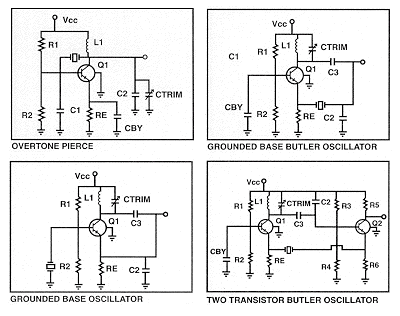

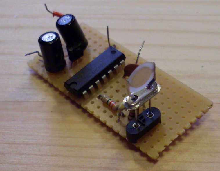

Here - this is an ordinary radio or computer crystal with the can removed. See that disc? Same idea as your ultrasonic resonator.

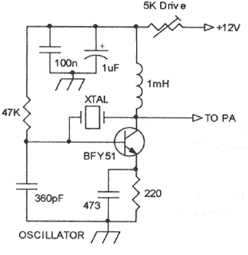

This is a slightly different version of your oscillator circuit. This one's an RF oscillator for a radio transmitter -
That transistor is your Q2.
Q1 in your circuit acts as a conductive switch, it provides the bias provided by the 47k resistor in my circuit. This bias voltage is necessary for Q2 to oscillate.
That filter I mentioned before is called an "RFC" - Radio Frequency Choke, same as the one coil in this circuit. It allows the collector voltage to bounce up and down like a spring. Dumb analogy, but it works.

Yeah, the first half of the circuit (Q1) is used to switch the oscillator part on and off. The base contacts (J3 and J4) of Q1 are mounted into a chamber so that the presence of water switches Q1, and hence Q2, on.
Like i say, the one part that i was having difficulty with was identifying the resonant components so that i could alter them to work with the 'holed' transducer and its new 1.56MHz resonant frequency.
So, are you saying that plugging the 'holed' atomiser into my original circuit should see it working correctly because the resonant frequency of the circuit is inherent on the load/transducer?

Just an after thought... the circuit is on strip board at the moment while its in test phase, probably not the best medium for high frequency propogation. Maybe this is part of the problem?
Only if you have a couple of feet of test leads to the transducer or something. Are you using a benchtop supply? It would be a smart idea to put a 1000µf filter cap right on the board itself, across the power supply leads.

Adding inductance/capacitance to an oscillating piezo circuit will 'pull' the frequency slightly. This is what's done to trim the timing in a quartz clock/watch.
That was a general reference to piezo oscillator circuits. For your particular driver circuit the values of C3, C4 and (to a lesser extent) C5 may have a slight effect on the operating frequency.
and possibly the oscilloscope probe accross the piezo?
Have you tried driving that input with a signal generator and observing the piezo response at the collector of Q2 like I suggested? This will help you move forward on the project. The technique is like tapping a bell with a hammer and listening to how it rings. The waveforms will convey a good deal of information that can help us understand what the problem is.
Hi, yes ive just this second tried it but i get nothing from the collector of Q2. Interestingly, if i replace the holed piezo with a normal one it rings just fine (both using a square wave sig. gen and just shorting J3 and J4 together as per normal), so the circuit must be working properly.
Its almost as if Q1 isnt being switched on and off by the sig. generator when i hook up the holed piezo, and yet if i plug the holed one straight into a signal generator i can make it resonate when pulsing 1.56MHz, so i know its not broken. :confused:
"Nothing" isn't a reading an oscilloscope makes. What does it show?
