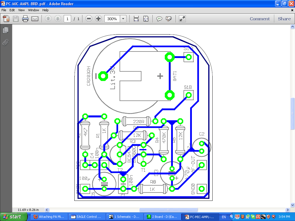

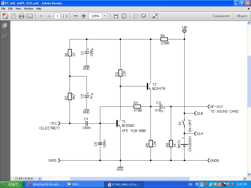

Here are schematic and PCB layout for a PC-Mic-Amplifier.
T1 must be a BC550C (hfe > 600)
AF-OUT connects to the outer pin of the 3.5mm stereo plug and Ground connects to the sleeve.
