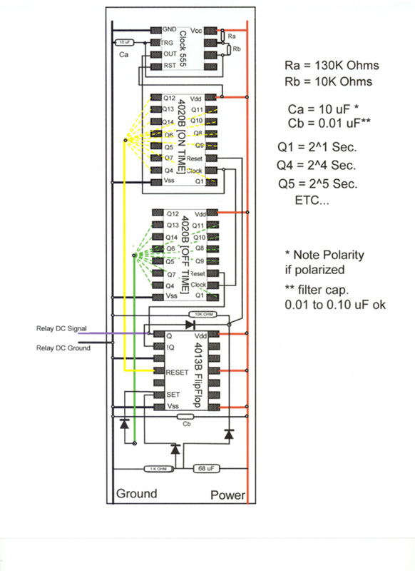

Attempting to build Repeat Cycle Timer
TCLynx
Boy do I wish I'd gone searching for an electronics forum for help on this first.
Anyway, I've found these instructions in several places but they are missing all the key schematics and pictures!!!!!

Here's the schematic of the completed cyclestat.
Be sure to add a filter capacitor as the schematic indicates (not shown in photos) to ensure proper timer functioning.
TIMER IMPROVEMENT
Below is the updated timer layout, featuring an "automatic on" function that restarts the timer in the ON position when power is applied. The resistance/capacitance values on the RC circuit are subject to what works. (The stated values worked for me, It's all about resetting the chips for long enough time intervals when power up occurs -- play around to find what works best for your timer.)
Shown Values:
Res. at bottom (added RC circuit) = 1K ohm
Res at middle = 10K ohm
Cap. at bottom (RC circuit) 68 uF.
I went and got all the parts in the list but when I went to start putting it together I realized I was lost.
I also got a little 555 timer kit that can pulse .5 - 5 seconds and pause 2-60 seconds. I was hoping the kit would help me figure out how to hook everything else up but it really doesn't.
I guess what I mainly need to know is what other connections on chips 2 and 3 need to be made other than the time. Also, what does the 4th chip do?

I don't know. What constitutes homework help? I'm certainly not in school anymore. I'd been searching for repeat cycle timer circuit diagrams and found some instructions that were missing their schematics. I think I have the parts needed but got a bit stuck when I started putting them together.
Alright it's an assignment. There has got to be a million LM555 projects / schematics and tutorials on the net, plus countless books on the 555. They've sold billions. Try 555 relay schematic in Google.
The 555 is sure popular everywhere, I would do what blueroomelectronics suggested. Or, you could do a microcontroller type project which might be a little more difficult.
How much current does your relay need? I think most require 70-100mA, but don't depend on my memory. The driver can be a simple transistor, depending on the current required. You might find this specification on the relay, or by experimentation. Knowing this will help figure out what the driver needs to look like.

Sounds like the OP would be looking for this: **broken link removed**
Ken
Thanks Bill and Ken, This is why I wish I had come across this site first. Now I'll probably have to go get some new parts if I can't find a drawing to explain how to hook up what I have.:eek:
Searching for schematics on google brings up lots of completely unrelated hits and even more patent sites than I know what to do with.
Bill, the diagram you posted, looks more like a one shot timer though I am not very good at reading this stuff yet so I could very well be wrong. I'm trying for a repeating timer that will keep cycling on and off for the periods of time adjusted until power is disconnected.
Ken, thank for that link. I've been there in my search these past few days. I guess I'll have to try some different parts for the timer I guess unless you think some of the parts I have could be substituted without too much difficulty. I suppose I can use the timer design in the link to help me figure out a different design in any case.
